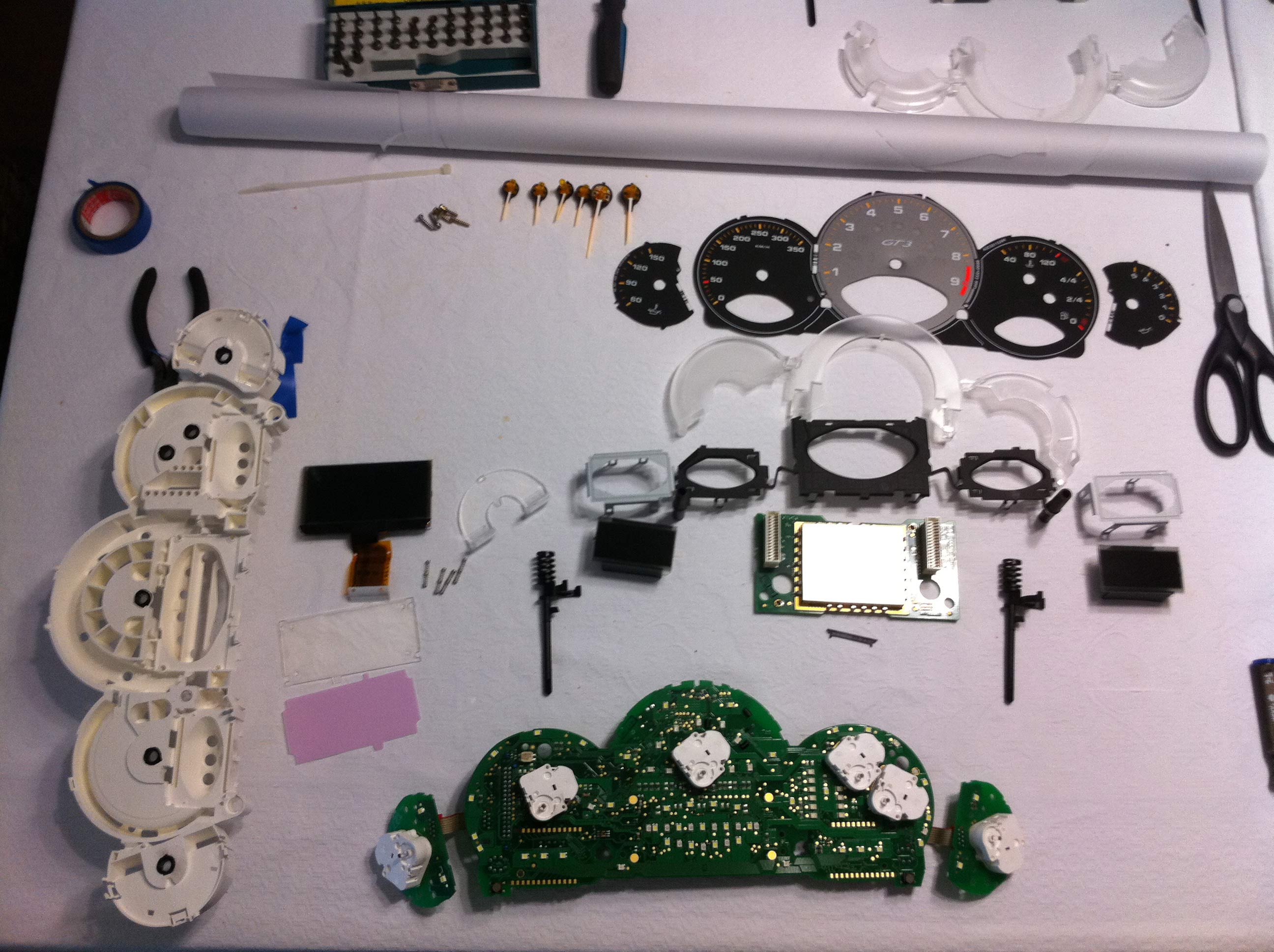

  2. You use a pry tool similar to the ones sold in this website: http://www.macarbon.com/store/accessories-9/ MAcarbon Interior Install Tools ( 3rd tool from the left ) They are press fitted, but you have to be careful not to push them too hard, before removing the needles watch the gap between the needle and the gauge face. The needles enter in some kind of hollow tube that transports light to the needles, but the hollow tube is connected to some kind of motor. I can tell you that this is not a easy task to do, so be careful. Best Regards, Alex

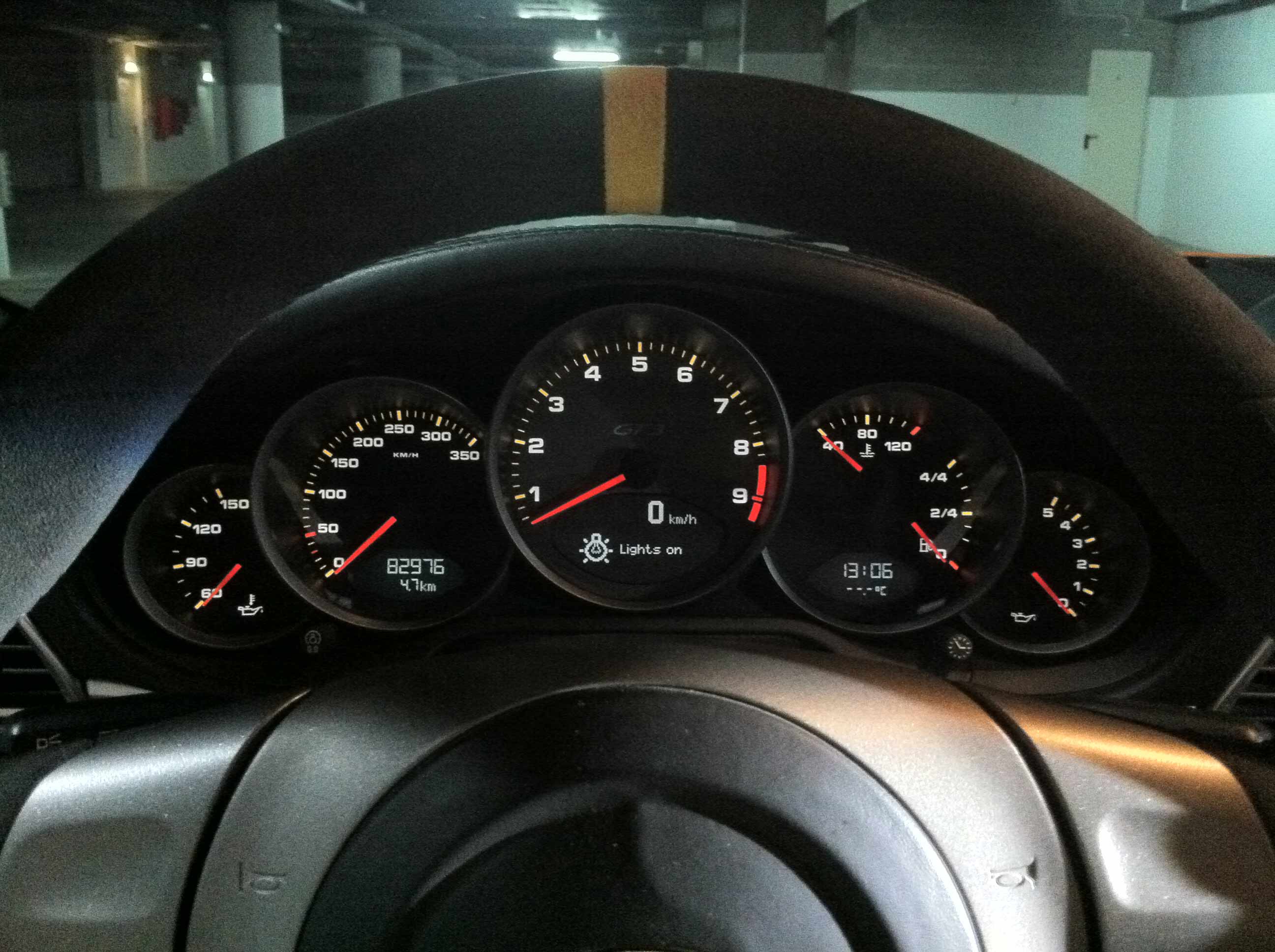

  3. Here is the finished product. Best regards, Alex

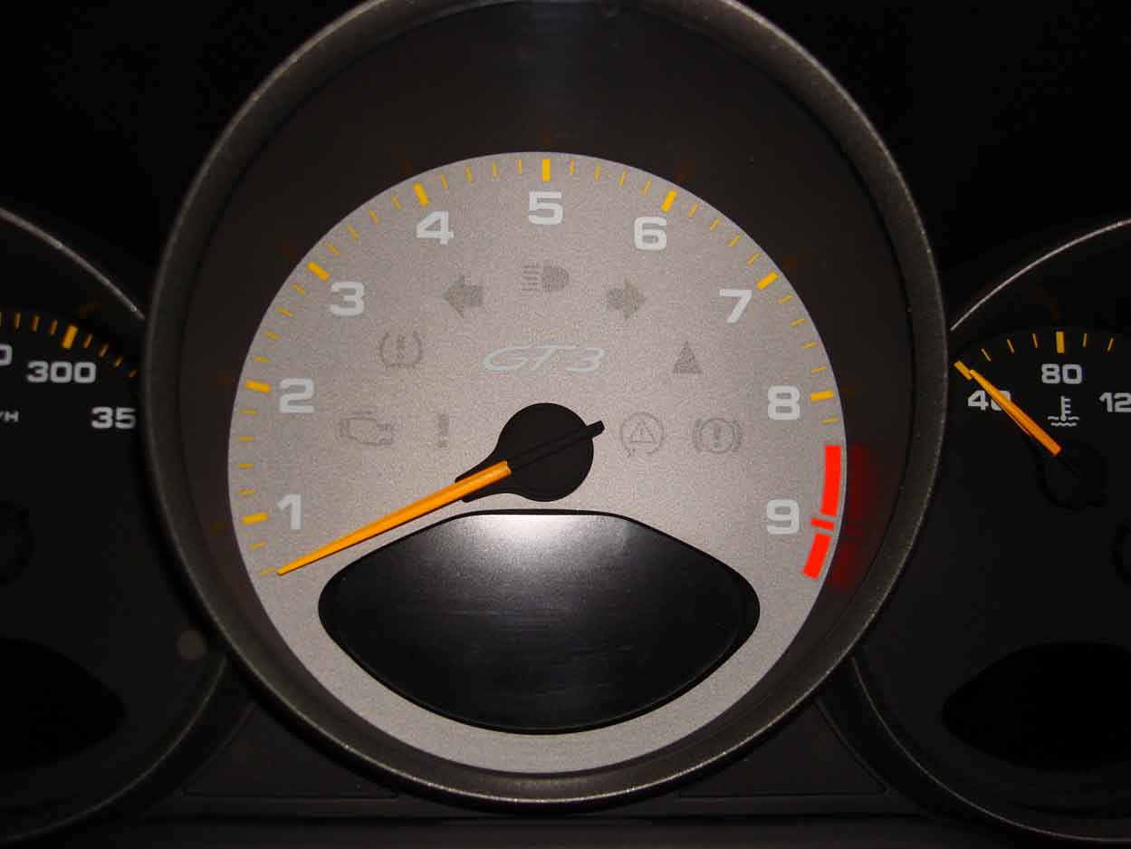

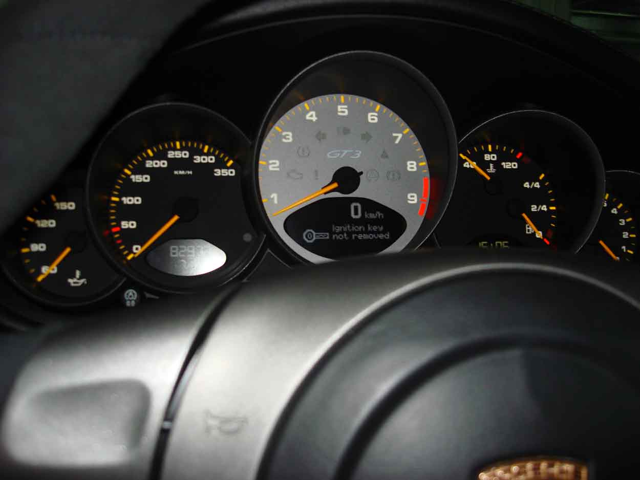

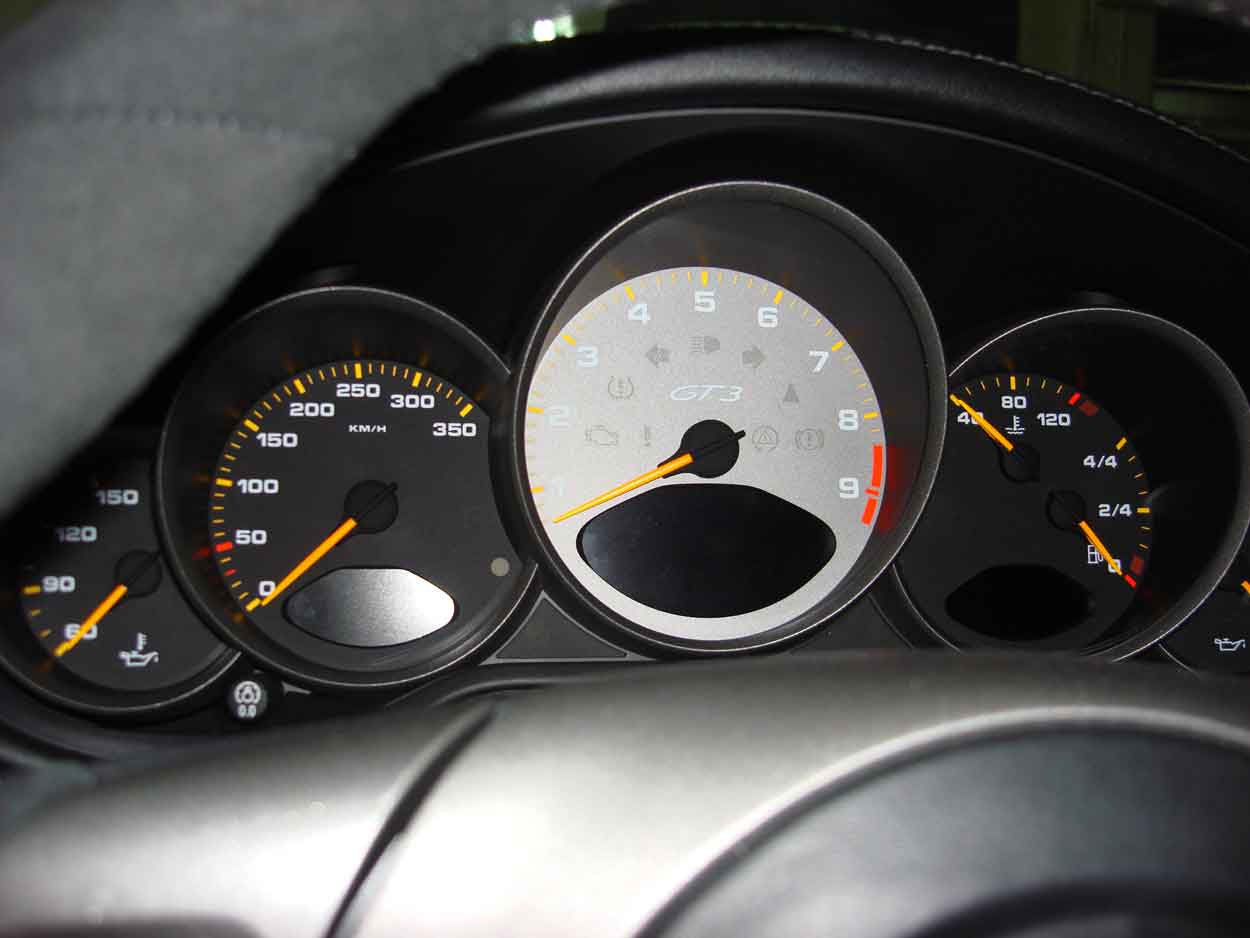

  5. It requires balls of steel to do it. Here is the GT3 gauge face completely dissembled. Here is the problem i had after changing the GT3 gauge face and needles to yellow. Even the needles were yellow with the light off, with the lights on the leds of the carrera S were orange, i had to take it all apart again and change the board leds from orange to yellow and final result was a perfect replica. Will post a picture later with the final result. Best Regards, Alex
  6. I inserted a GT3 One. Looks so good. Had to take out the needles for a couple of time to make the right adjustment, but didn´t broke any. I bought a GT3 complete cluster. Took it apart and removed the needles of the GT3 and after that the gauge face. Installed everything in my Carrera S gauge face, even the yellow GT3 needles. When i fired up the gaugle cluster the yellow needles were orange, the led in my board was orange. Had to dismantle my gauge face again and change the leds that give light to the neddles with the ones supplied with the GT3 gauge cluster. Now it is perfect. Best Regards, Maika
