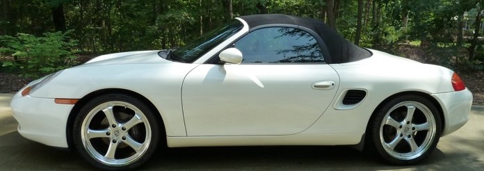

  6. I just bought and installed a Sierra top from Auto Tops Direct. I got the A5 Acoustic with the glass window and defroster including cable for $679 plus shipping. The material is noticeably heavier than the original, and the acoustics are much improved. After you buy, they send a pdf file with excellent instructions -- the best I have seen. I have done a lot of mechanical and trim work but never a top myself; I was a bit concerned. I was able to get it done by myself in two four hour sessions. No problems. Just be careful with the adhesive and stretch the corners taut but not crazy tight. The 3M contact adhesive they recommend in the instructions does come off with acetone if you slop some.
