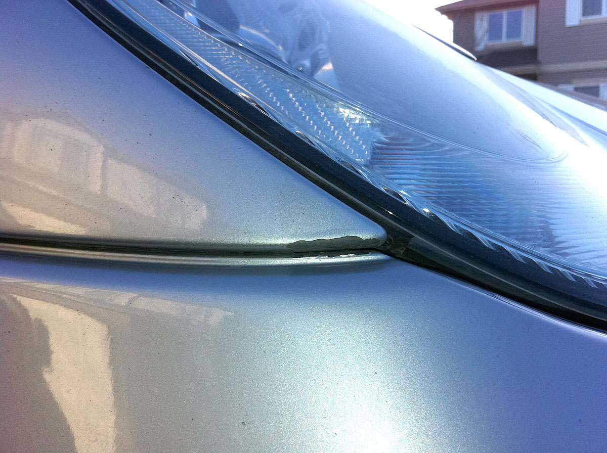

  4. Well, I'm a photographer, so high rez images are easy. I am trying to keep the file sizes down however, but I think these show the damage pretty clear... sean
  5. So, I've had some coolant leak issues for the past 6 months....the dealer replace the front right rad in January....and the about 3 weeks ago, replace an o-ring in bypass valve on the front left rad. I had to go back to the dealer this weekend so they could replace an overflow tube or something like that on the coolant reservoir. Saturday morning, I was washing and polishing my car and noticed the front bumper was not seated properly. The gap along the bottom of the headlights was larger than it should be. So I starting examining more closely and found the following damage where the bumper and front right fender meet. To me, it looks like tool damage. Like someone used a big flathead screwdriver or pry bar to remove the bumper and removed a bunch of paint on the bumper and fender. It takes a lot to remove paint from the fender. This damage was NOT there the last time I washed and polished my car (a month ago) I showed it to my dealer when I went down and the service advisor said it just looked like a normal rock chip that might have "creeped" :| She said she'd show it to the service manager and get his feedback. When I picked up my car, she was occupied so the VW service rep had to give me my keys. No mention of it on the work order, the service manager wasn't around or available and I was left to drive home without any further communication. About 1 hour into my drive home, I wish I had stood there and insisted on getting more dialogue about the issue. My bumper has lots of dings, scratches and even some cracks (in the paint)....but it's plastic. I don't care as much. The fender is metal and a possible corrosion point. Not to mention, repairs are more costly and frankly, they never seem to be 100%. I'm just looking for some second opinions....does it look like a normal rock chip or some sort of "man made" damage? Thanks for your opinions, even if they vary from mine ;) sean
