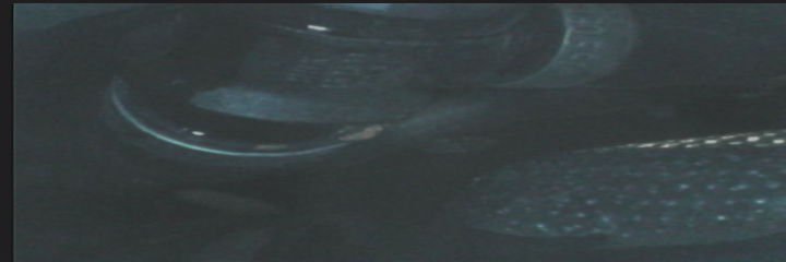

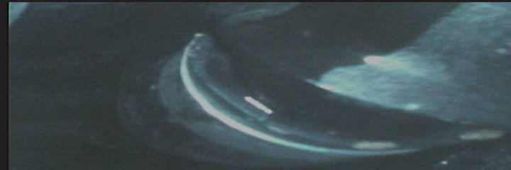

  1. Hi Everyone, So I got a 2004 Cayenne TT and got a call from the wife last night that the red "low coolant" level was on the dash when she started it. I had the car towed back to my house, and got it on the lift this morning. The coolant tubes have been done (aluminum upgrade) but was worried it might be them again. After scoping the engine from above It was all dry and I could see the back of the aluminum tubes and didn't see any coolant anywhere. So after raising it up and going underneath the vehicle I scoped up the back side of the engine and came to what looks like an elbow off the back of the large coolant tube, and at least initially it appears that rubber elbow has a gaping rip in it (see picture). Sorry the pictures of it aren't the best but my scope is old. After looking at a diagram of the coolant tube system on the car I've determined that I'm pretty sure this ripped tube is what I have circled in red in the diagram below. My question is, do I have to remove the intake like to replace the aluminum tubes to get to this, or can it be done with it in place without intake removal? Thanks for any help! UPDATE: Just a quick update, what I thought was a rip in these photos is actually the metal "T" partially slid out of the rubber hose. I verified it is definitely leaking from there via my borescope and having someone dump a cup of distilled water in the reservoir. So basically I'm thinking a clamp/fastener gave way and the pressure of the system has allowed the hose to come off the metal "t". So it is definitely the "t" in that is circled in red in the diagram, question still remains (haven't yet had the time to pull all the engine panels off yet) can I reach it without intake removal. I'll know shortly just by removing everything just thought someone knowledgeable might know, thanks again. z
