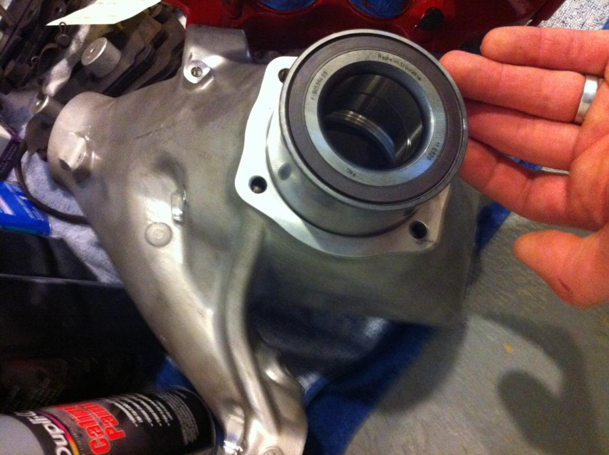

  7. I'm pressing wheel bearings in a 997s front wheel carrier. The bearings are sealed bearings. The seal on one side is red and the seal on the other side is black. I'm trying to decide which side goes in and which side goes out. I've heard that one side has the ABS cog inside of it- the grey side. This grey side goes "in" (faces the center of the car). Is this correct? I've really only got one shot at this so I want to make sure I get it right. Thanks.
