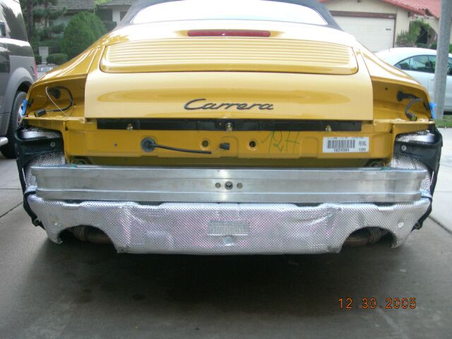

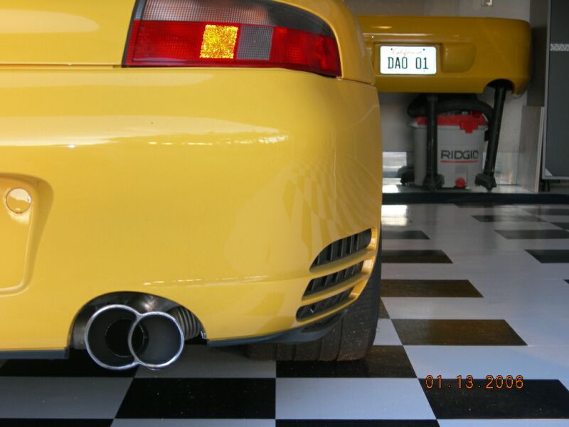

  1. True, this is an unmodified TURBO bumber so it is wider then the body. My thought was doing the full widebody conversion in the near future that's why I didn't modify the bumber.

  4. Overall, I'm very satisfied with how it turned out. The paint job was done by the same painter that painted my RUF front bumper, he mixed extra as he knows I'll be doing the rear so it turned out perfect. The hardest step is to find out all the parts needed and that's why it took me so long. For the brackets I use 1" by 3/16" aluminum bar @ HOMEDEPOT. If I have to do it all over again it would probably take me around 5-6 hours top. My appreciation goes to JEFF @ SUNSET and DONCAPECOD for assisting with pictures.
  5. Finally got around to complete the Turbo/C4S rear bumper conversion on my 02 C2 Cab. Overall it turned out OK not a perfect fit but about 90%. At least it is all factory parts with the exception of some brackets I made to hold the bottom correctly to the heat shields. Porsche C4S rear bumper conversion 1. 996.111.352.02 Left tailpipe extender (1) 44.72 2. 996.111.351.02 Right tailpipe extender (1) 44.98 3. 996.111.981.03 Left DualTip Tailpipe (1) 272.25 4. 996.111.982.03 Right DualTip Tailpipe (1) 272.25 5. 999.507.696.00 U clamps (for grills) (24) 4.08 6. 996.505.411.16 G2X Bumper C4S (1) 1065.48 7. 996.505.663.01 01C Grill Vent Left (1) 82.88 8. 996.505.664.01 01C Grill Vent Right (1) 82.88 9. 996.505.475.04 Center Rear Heat Shield (1) 124.28 10. 996.505.837.03 Retaining Strip (1) 45.00
