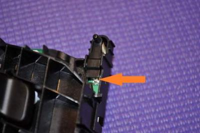

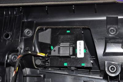

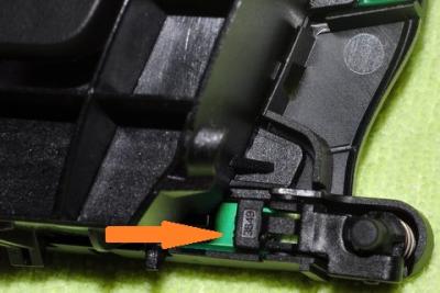

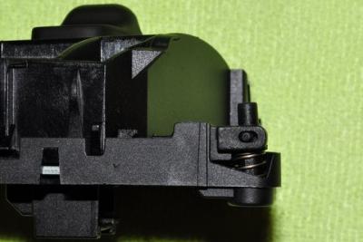

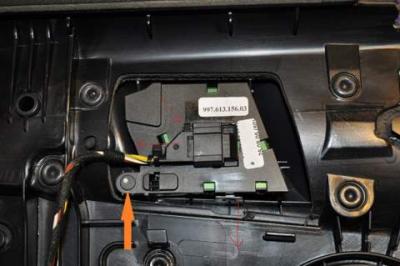

  7. Thanks Paul, the dealer said its the latch 9 out of 10 times, but I still think its the switch/sensor at door handle. Marcus, you are right, I did the disassembly. Here are more details along your line of thought. Here is the picture of door panel. Solid arrow pointing to the plunger, which pushes on the microswitch. (removed from the door) Following picture shows the reverse side, arrow pointing the location of the plunger. Red arrows point at the connector release tab and the tab below to release the module itself, note the part# 997.613.156.03 Following picture with the module out and arrow pointing the plunger location hole. Front of the module with arrow pointing at the plunger. The white microswitch is visible in the right picture Following picture with the module front and back separated by releasing the tabs circled in red. And finally the plunger/lever out and the arrow pointing to the microswitch itself, which is part of the power window switch module. I did not get a chance to check if the microswitch itself in faulty. Next I am going to check with the dealer on ordering this window switch module and test if this resolved the issue. I may have lowered the picture quality too much. Let me know and I can upload better quality pictures.
