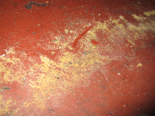

  2. Well, checked the coolant level the other day, the level was low. It was very suprising for me that the color is yellowish. Porsche special liquid? I still cannot find any leaks. Will have to take apart the plastics around the tank. I have read here about somebody having leaks close to tank, or the tank itself. I do not wan't to take it to local Porsche, for examination. I am planning to have the coolant pipes changed, but I am a bit nervous about taking it to local shop here in Zaeagoza, Spain, as a foreigner. I work with Spanish sub contractors... Nice people, it is just the culture difference. I have driven the car about 1000 km, and was so stupid that just now I checked the level of coolant. I was a bit lower than the minimum level, but as I have`witnessed some liquid under the car only once, I'm suspecting, that it does not leak anymore after the level is at certain point. Any body know about coolant leak that show at the front differential, as in the pictures? My Cayenne was last maintained 25000km ago and soon it is time for 120000km maintenance (90tm). The car was not driven much before I bought it, the last maintenance was done spring 2008. It was about time somebody checked the liquids. It also has occasional alarms from turning signal. I suspect corroded connection. have to tear them a part and clean them. When I get to finland, I will have to also do some "touch-up) painting under the car. The over lapping connections in front carriage look already quite rusty. Mediterranean environment and stupid use of road salt... Antti

  4. HI fellas, been a while, was on holidaym enjoying Sunny copacabana beach... Back to business. After the holiday, battery was dead, no driving for 3,5 weeks (Quite normal) After some 600km of highway cruising to Barcelona nd back, should be ok. Well see. Jump started without any problems. No allergic reactions from Seat Leon (Spanish VW golf). After lifting the suspension to highest position, removed the bottom cover. My friend was turning the wheels, engine running, while I was inspectiing under the car. Could not find any leaks, which is not nice. Would like to know what is it, so I could fix it. (Dont fix it if it aint broken? ;) ) Here is some pictures, first the front differential with yellowish color. Definately not gear oil. Does not feel like or smell like it. On the floor there is residue, which I suspect to be dried pentosin, steering fluid? During these 600km, there was no significant loss of steering fluid. The liquid leak earlier on the bottom cover evaporates comletely... I have no smell of coolant or any sign of leaks... Any ideas? I just need to keep driving it until it tells me what is wrong, I quess.
