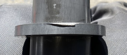

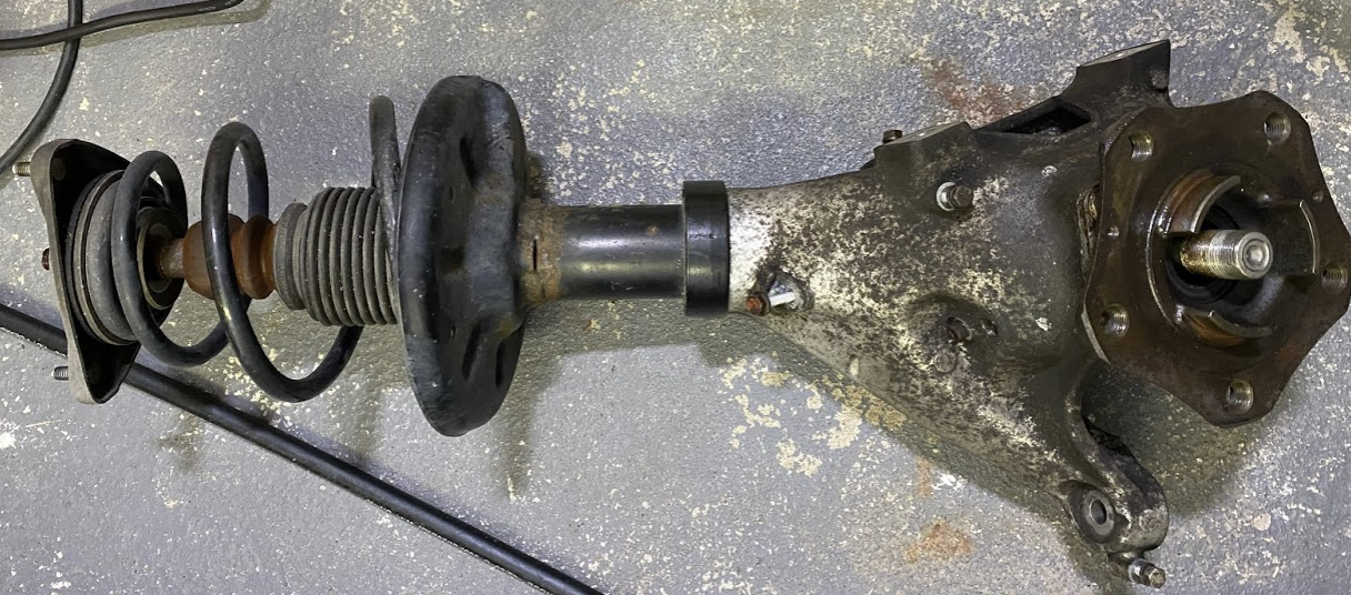

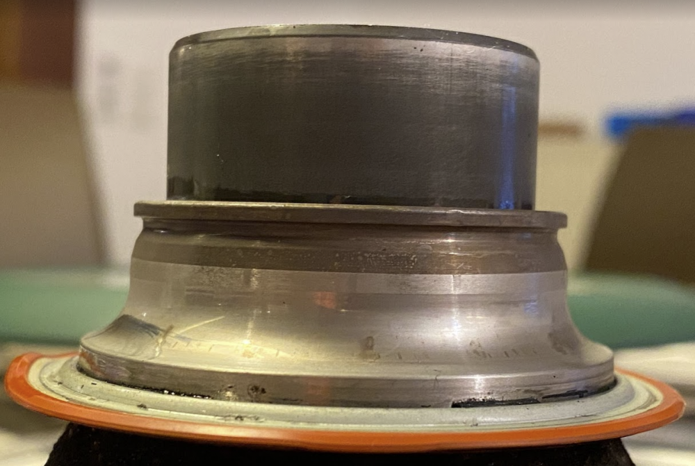

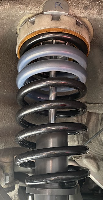

  1. Update: 13 laps at Nürburgring and I heard some clunking in the rear and tire strike to the front Left inner fender lining. The problem: I installed Bilstein B8's which require a sport spring so I opted to use the Porsche 030 sport springs. It's not a match. This is the spring at No Load. This is the spring at static load. You can see that the lower coil loops over the Spring Stop. Perhaps the Porsche Spring Stop, or whatever that collar is called, is wider? After discussing with Bilstein and some track shops, they all recommended the 'Intended Match' as the Eibach Pro Kit Springs. So I ripped everything apart and re-installed the Eibach Springs. Unintentional contact: This explains the clunking... Look at the height difference. Installed... I was too lazy to take photos of the front springs... but you get the picture - Always go with the mfg recommendations. I left out the boot because it looks cool, I can clean them, and when they are toast, I'm upgrading to coil overs. While I was in there, I installed Steel braided brake lines and the center radiator. Note: I purchased this spring compressor back many years ago for about $300 and I can say that this is one of the most useful tools in my set. BTW, it's an X3 strut/spring. Now I have to wait until the snow melts.... Nothing else to fix. (for now)

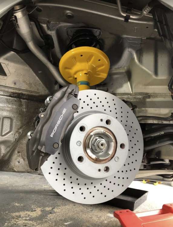

  3. So I finally received the front struts, installed, checked by Porsche Zentrum, received a TüV Certificate! My feedback on the 030 Sports Suspension swap with Bilstein B8's. This is a track car, not for the soft spined street driver. If you like to really push it hard and learn that this car is better than you are, do it. I'm really enjoying it. That said, I doubt I can drive more than 3 hours without an Aspirin stop. Plan A is now to take some lessons at Nürburgring!

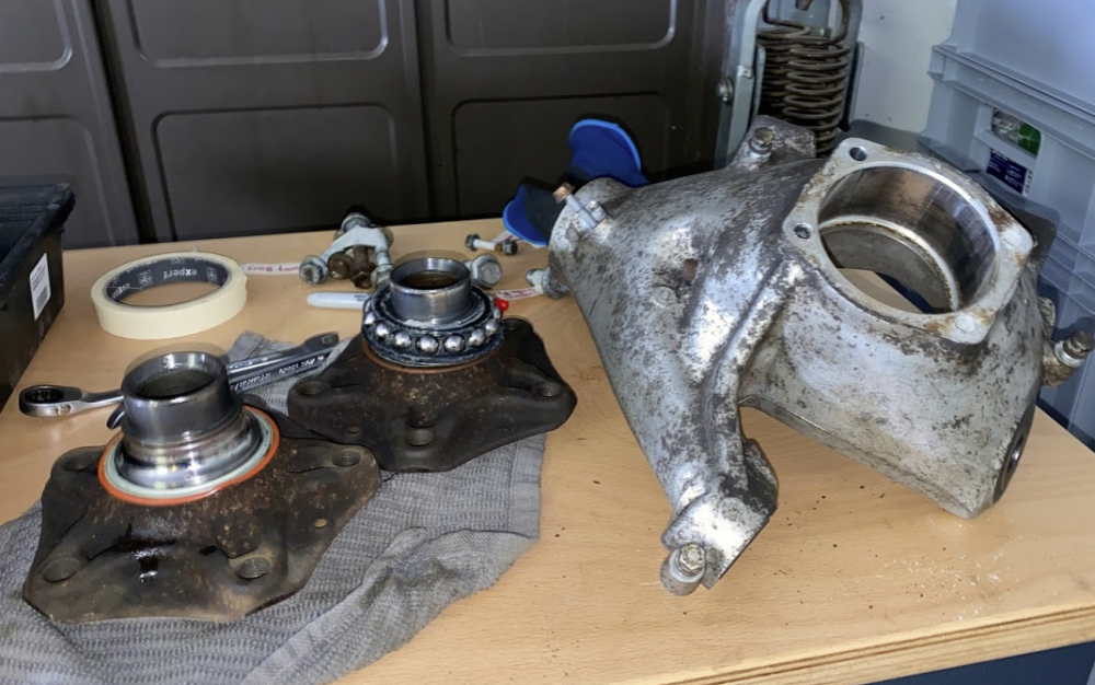

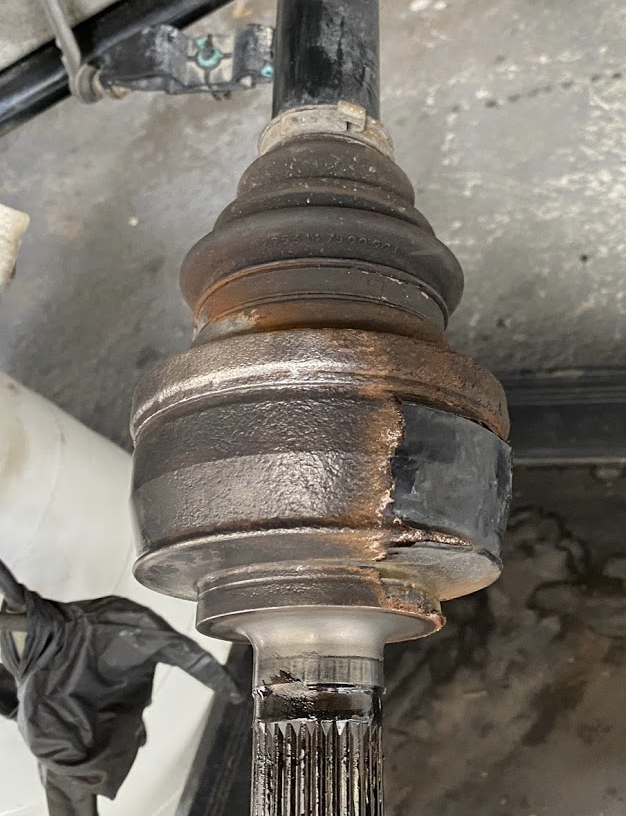

  4. Hey WTL, I had a bad boot so I just yanked both axles out, bought the boots, and swapped them out. Easy. Since you seem OCD, after you do this, you'll sleep better at night. This is a photo of the unit after spending an hour wire brushing it. I don't have pictures of the boot swap but it looks alot faster with the rust gone, fresh paint. Rust removal attempt on-car. FAil. Remove both side. Appled paint remover... no impact since they used some paint which resists chemical. OCD Clean Once cleaned, I removed the boot/replaced it. Just get the proper (Out) circlip/clamp plier or the clip will fly.

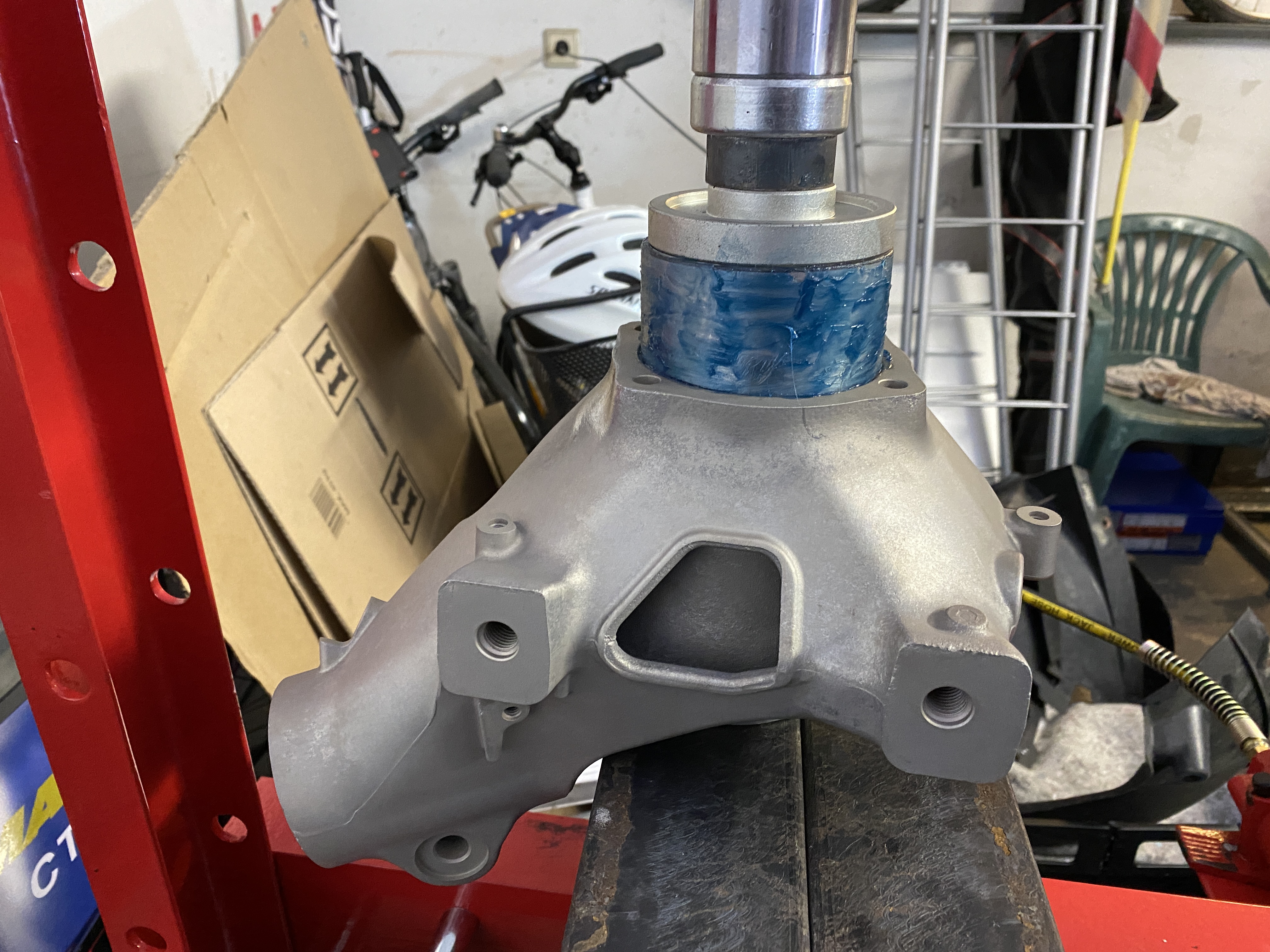

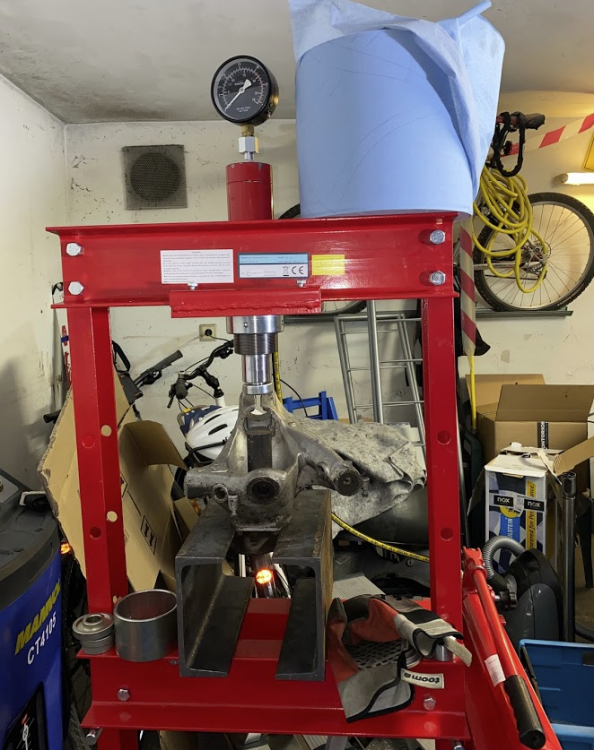

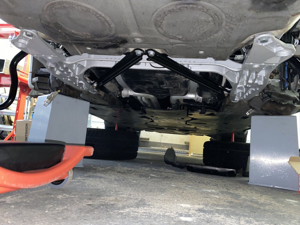

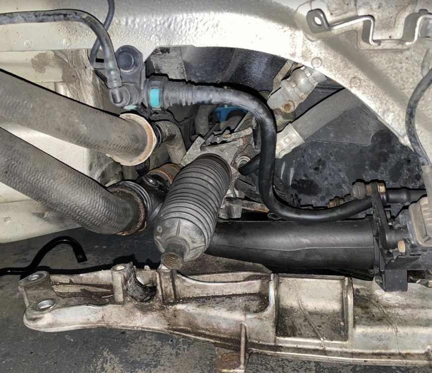

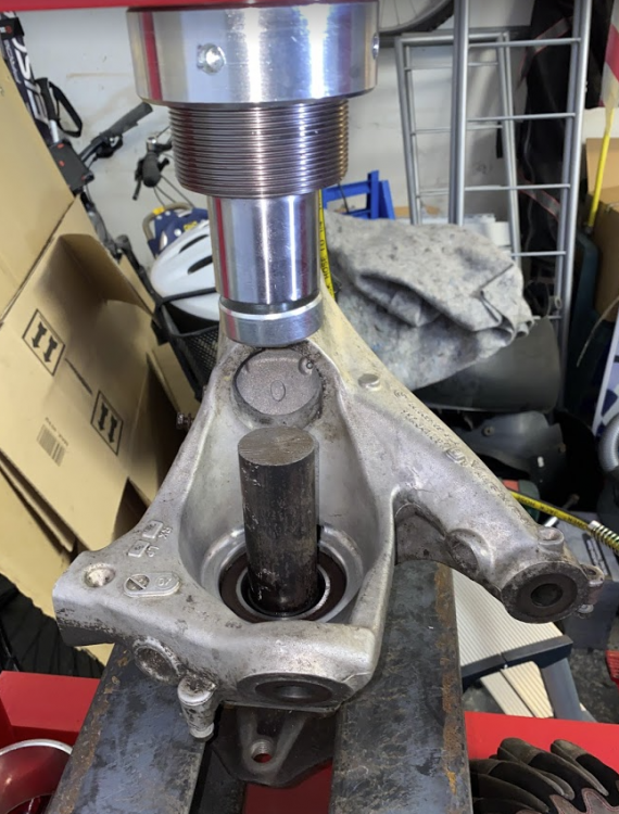

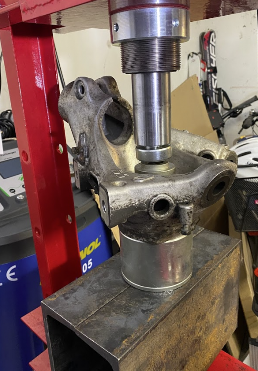

  5. Well, I suffered 'while you're in there' syndrome... I discovered that all of my cooling system hoses, couplings, and tubes were rusted so I removed them but in doing so I decided to remove practically everything except the steering unit. This is the price you pay for enjoying drifting in the snow! It was worth it! I then discovered Dry Ice Blasting so all of the re-usable components were blasted clean. Next, I painted everything with a under body paint. (masked off all of the mating surfaces). The bearing pressed in easily as I heated the wheel housing to 100C and froze the bearing over night. So now I'm off to put things back together! The only challenge was figuring out how to align the cross-over tubes which have to be inserted after the cross member/steering gear are in place... My rear struts (the reason for all of this) are still on back order... I also discovered that I need B8's to match the lower spring height of the i030 suspension setup... I discovered this when the spring was loose during a test fit. Anyway, B6 vs. B8: B6 is for normal suspension, normal spring height, B8 is for lower spring height, Damping is the same, B8's have the proper spring pre-tension. Oh well... B6's are on ebay.

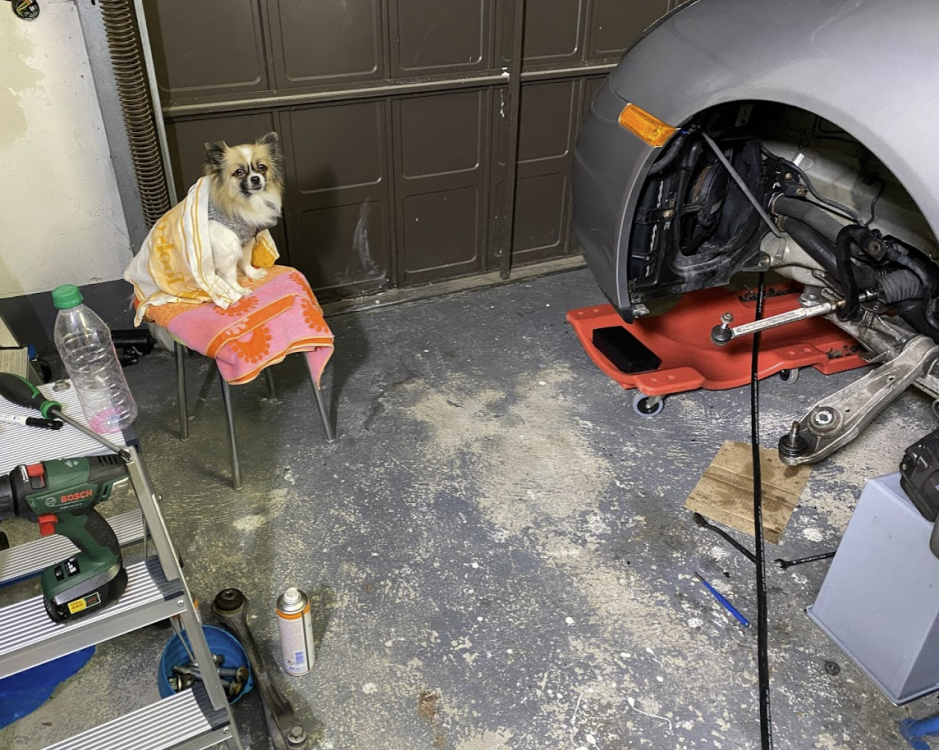

  7. Germany has been on lock-down so I decided to swap the standard suspension I029 with the Sports Suspension I030 and Bilstein B6 mono-tube struts. Scope creep and OCD kicked in because I thought if I'm replacing the front sway bar to I030, lots of things are coming off. Most everything just falls off with a socket or a wrench but I ran into a stuck lock-nut on the tie-rod so I purchased a nut-cracker. They work great. What really shocked me was when watching Youtube videos on people removing the wheel hub or bearings, they just seem to drop out or fall off with a simple puller. In my case this was not happening so I went down this rabbits hole of total DIY. Purchased: Bilstein B6 Fr/Rr (rears don't arrive until Feb so I started dismantling the Fr) Porsche FR/FR springs/swaybars Meyle control arms/track arms (all) *** bearings (I could feel the rumbling) Plus, what the heck, I'm in there so... hydraulic Nut cracker for the tie rod lock nut. These are great! Large 3-prong puller Small 3-prong puller Bearing separator Bearing puller set 20T hydraulic press 36mm crow foot socket (for the tie rod) C-channel to mount the wheel housing 40mm x 100mm rod to push the wheel hub out 60mm x 100mm rod to push the bearing out Self Portrait. Bare. Return line has a small leak so I'm also going to replace all of the hoses while it's all visible. 20T Press. Chinesium, 234 euros and it works great after topping off fluid and bleeding the system. Post usage: I can't believe how simple life can become with a press! 40mm x 100mm rod to press the wheel hub out. cost 20 euros on ebay. Wheel hub out. Manometer measured 2Tons before breaking lose. Setup for the Inner Bearing Race. It took 5 Tons to break lose. 80mm x 100mm rod for final push out. Bearing is 80mm length so it's a long drive. This is the last item to detach.... Bearing inner race half that is up against the wheel hub shaft. I used this clamp to finally remove the race. I guess these are the steps you don't see on Youtube. It's amazing what you can get addicted to when bored at home in lock-down.

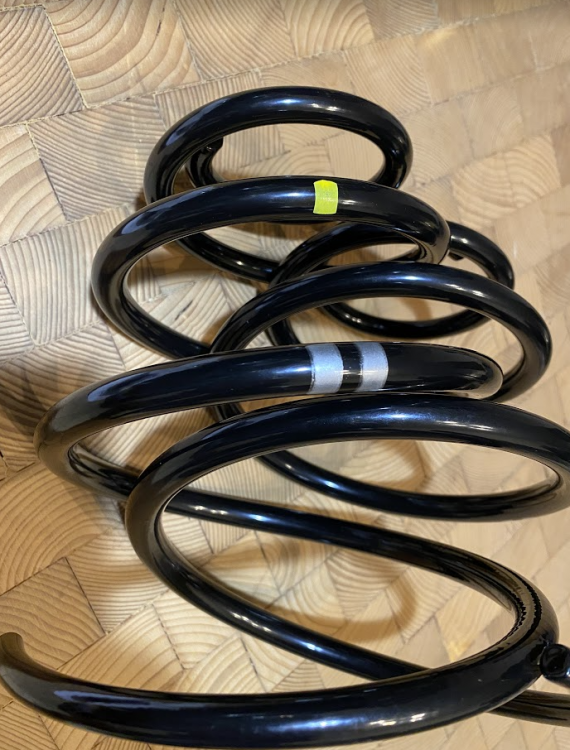

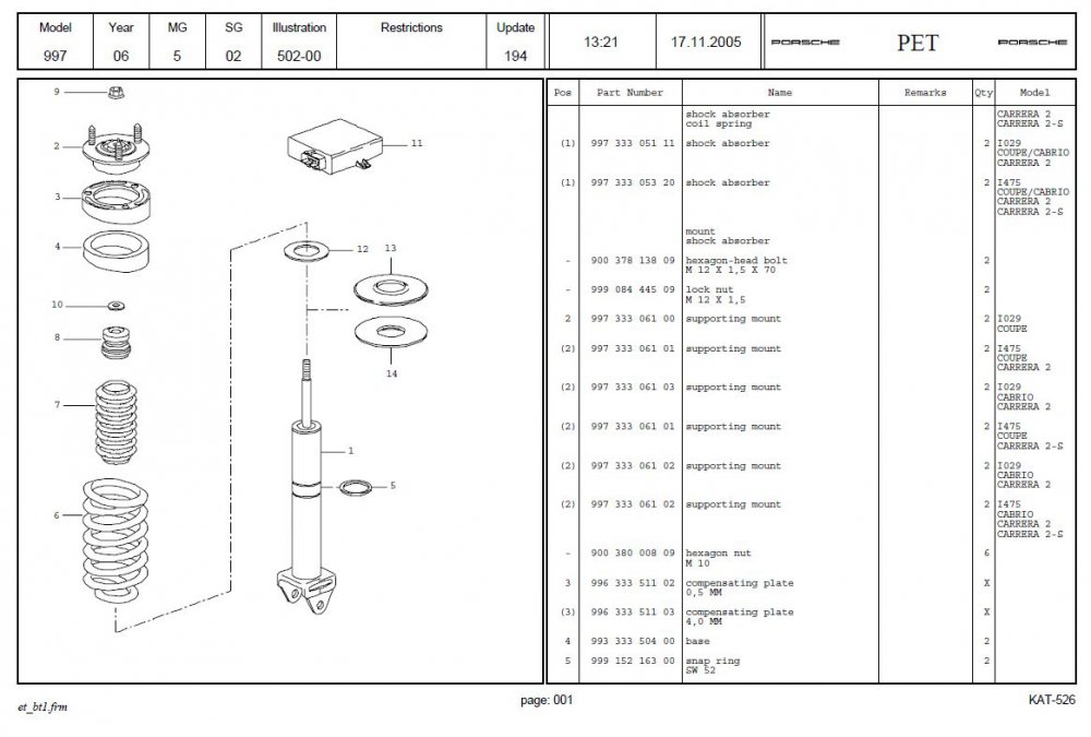

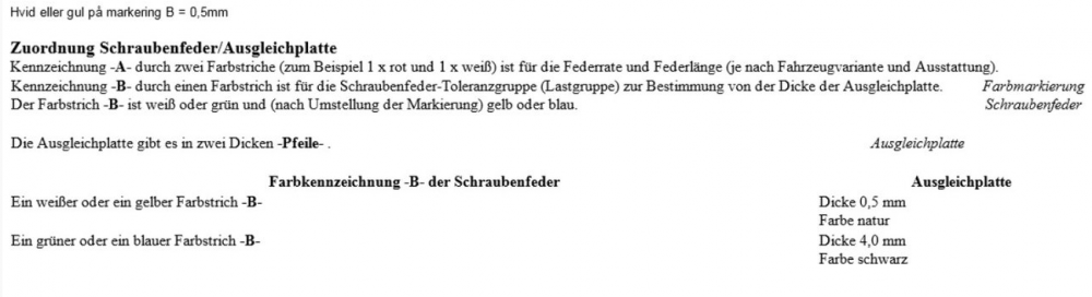

  9. Yes, it's Yellow. I just found a page but no confirmation... Spring color codes and compensating plates - Rennlist - Porsche Discussion Forums RENNLIST.COM 997 Forum - Spring color codes and compensating plates - I just had a broken rear spring, suddenly in the morning (actually heard it snap walking by the garage door, go figure...) Anyway, I got a new OEM set of rear springs matching my 06 4S PASM, Manual Coupe. Spring code... This image mentioned White or Yellow = 0.5mm, which to me is... really negligible.
  10. Update on this. i decided to go with B6's and to upgrade the coils and sway bars to i030 which is the sport suspension. The Rear B6's are on back-order so I won't see it until Mid-January. I received my Fronts and I ordered the i030 Coils p/n: 997 343 531 43 504. I noticed that the Color Identification for the Compensating Plate is: A (lower one): 2 x Silver marks. B (upper one): 1 x Yellow mark. My manual only lists: (anything but Silver/Yellow) I know I'm in hack space but does anyone know what compensation I should use for the i030 sport suspension coil? Thanks, in the end, I might just take a wild guess, after all it's only 3mm off. Thanks!!!

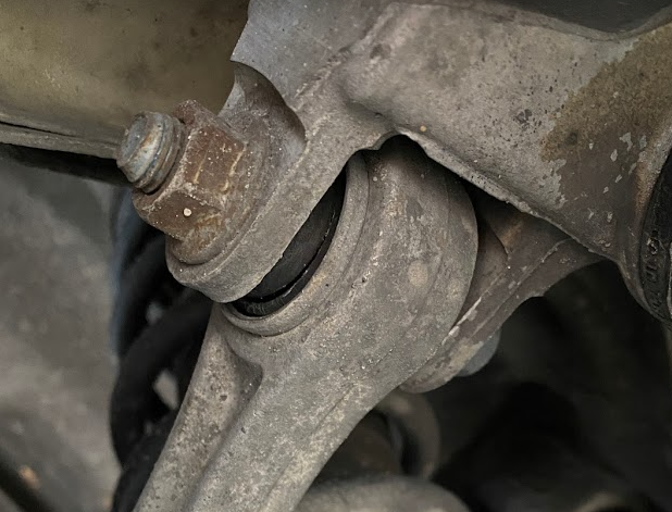

  11. 997.1 2008 non-sport suspension 100k KM I was under my car to replace the starter cable and shocks. I noticed that the rubber bushing on the upper and lower control arms or Wish Bone or Querlenker(DE) have rubber separation. Is this normal? No issues driving. Thanks! Ken

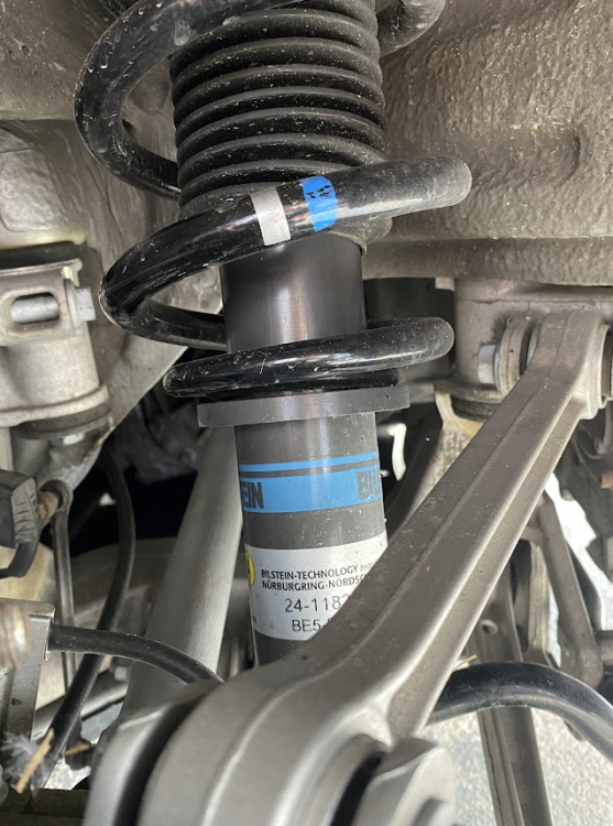

  15. I was changing my oil/filter and discovered that one of my rear struts was leaking fluid. Question: Should I go OEM or 'OEM' replacement. The oem p/n is 997 333 051. When I look up this part in Autodoc.de I get this: Bilstein B6 high perf. shock abs. 24-118224. Does anyone know if Bilstein provides oem to Porsche/997? Has anyone installed these? Any advice? Thanks! Ken
