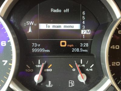

  5. yes for freeway driving but he's doing low speed "offroad" driving i guess it's normal No matter the driving conditions my temp never moves off the 180 mark even with the AC on full chat and climbing hills. I would just make sure everything is up to par. I picked it up with 82K miles on it. Did the coolant pipe check of course and it has been taken care of. I had just done 4 miles of dirt road (not really 4 wheeling) with the A/C blasting. Notice 75 degrees at 9700 ft. elevation! It was a very hot day! As we came down Big Cottonwood Canyon on the other side, every 1000 ft of drop=10 degree increase in outside temperature. By the time we hit the Salt Lake valley floor (~5000' ele) it was 105 outside. I've got to schedule the 100K maintenance interval so I will have things looked at then. I've got an indy shop close, but they don't have a PIWIS to check the codes. I've got a Durametric, and I am not getting any cooling related codes. My local dealership is pretty decent so maybe I'll have them look into it. Any idea what the average cost of that service interval should be?
