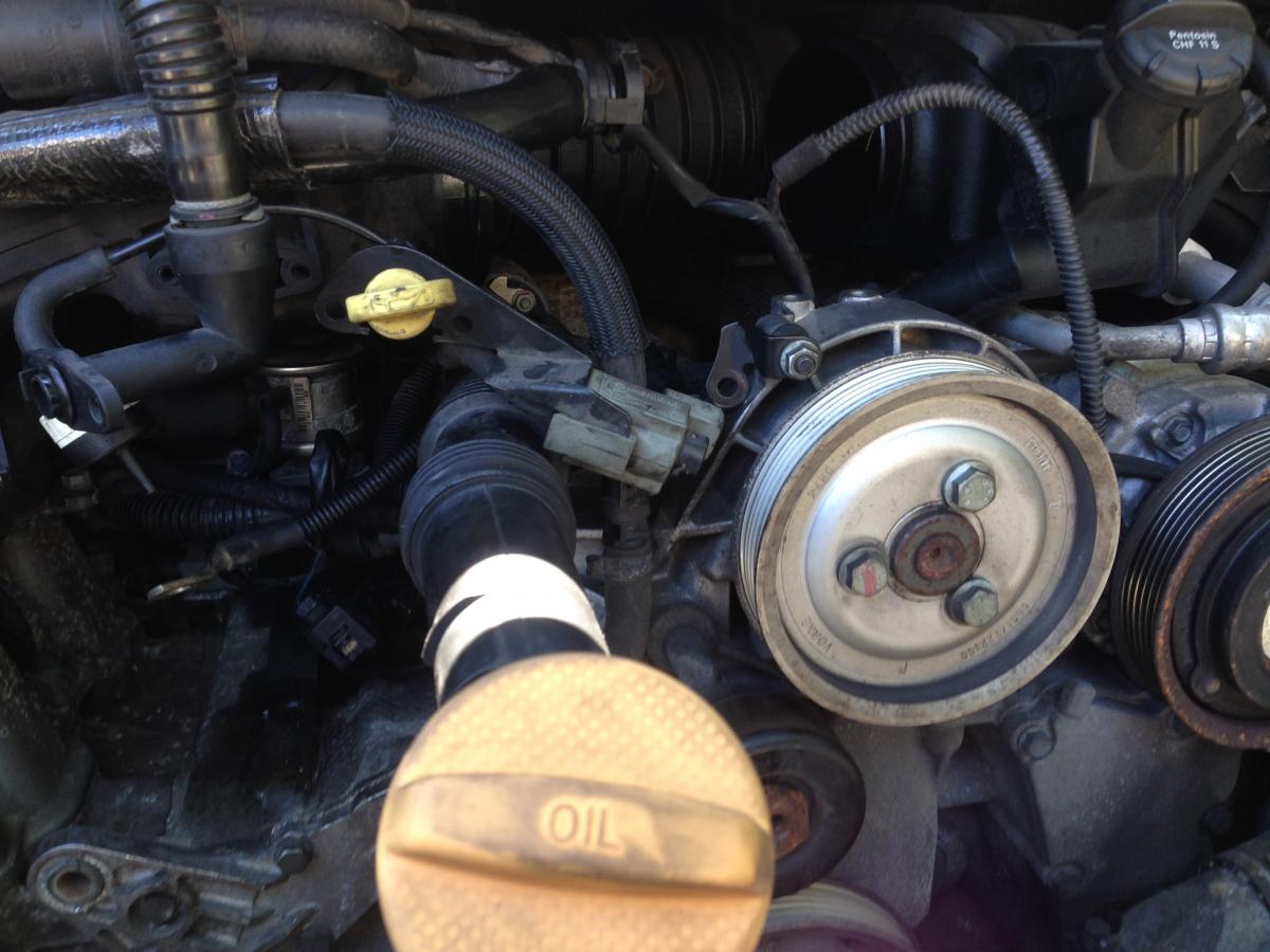

  6. The angle looking at changeover valve #2 is just right so you can't really see one of the elbows. Circled in Blue below: It's a little confusing ordering the parts since the diagram that Porsche uses shows the old style shut off valve from 1999 which has a bit different plumbing.
  7. I replaced everything seen in your pic: Except not the plenum or resonance flap actuator. Also, the dealer only gave me 1m of line, not 2m, so the 122mm bit is still original, but that's the easiest one to replace later. Also, I mis-counted the number of elbows needed, so the elbow to the one way check is original. Again easy to replace later. For anyone doing this in the future, you need 5 elbows, not 4. While I was in there, I replaced the starter. I also replaced a couple hose/line holders that I had broken previously when replacing the alternator last year (maybe 2 years ago).
  8. Good news, it's been 3 days since I replaced everything, and no CEL. It seems to start quicker, and hold a more steady idle. Even better, I passed emissions today! Thanks for the help Ahsai!
