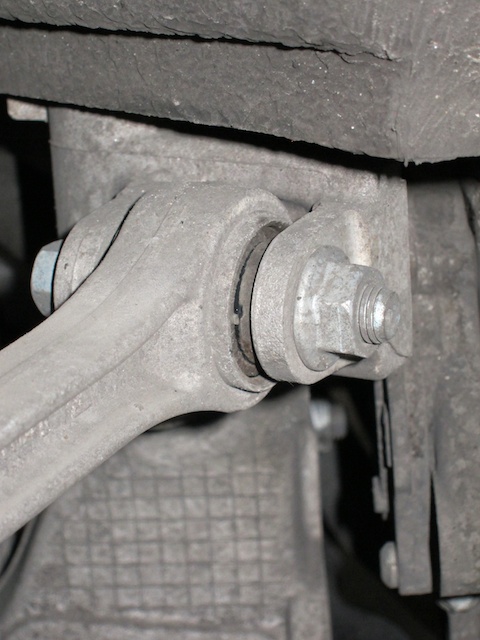

Hello everyone, Slowly solving my front suspension rattles on my 2006 C4S ( 80 KMiles), I now start to have very heavy noises from the back when hitting bad road It happens all the time when I brake on a manhole that wouldn't be at the same level as the road, or accelerate on a bad road The noise is more like Bang than clunk... I am thinking of the trailing arm I took some pictures of the bushings of the rear suspension, they look cracked to me The rear suspension can cost me a fortune to renovate, and I want to proceed piece by piece Any idea? Thanks Michel
I ordered 2 trailing arms for the front, I guess wheel realignment is needed? can the bolts be used a second time? I also had some heavy noise when hitting a pot hole from the rear, see what I found, the bushings seem to be broken, there are all like that, even the bushing of the shock absorber, I guess there must be one elements being more faulty than the others, by where would you start? It seems that control arms last about 80K miles on a 911, though I don't see much documentation on that on the net, there is always one person changing a part after hearing a clunking noise ( like me), there must be a logic order on what is getting worn first, anyone would have that ? Thanks again for all your advice
