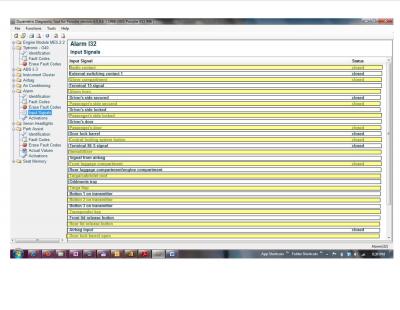

  4. 99 996 C4 50kmiles, bought a couple of months ago, power locks was not working. Good price so I thought shouldn't be a hard fix. The problem; If I use the key to lock, I can hear the gas door actuator cycle and a couple of clicks under the driver seat. No obvious sound from the door lock actuator. horn beeps couple of times and passenger door remains unlocked, driver door is locked. Same behavior when I use the key fob except, driver's door remains unlocked. Removed both driver and passenger door lock assembly checked all microswitches based on the article on "renntech-Diy common fixes" Inner and outer door handle switches work fine. Only microswitches I haven't checked are trunk and decklid. I put the durametic tool on it and here are the screen shots Drivers side secured closed Passenger side secured closed Drivers side locked blank Passenger side locked blank Drivers door blank Passenger door closed Front luggage compartment closed Rear luggage/engine compartment blank. what is confusing is that "Driver door secure" conflicts with "Driver door" don't know what to make of it. "Rear luggage/engine compartment" may be a problem too....
