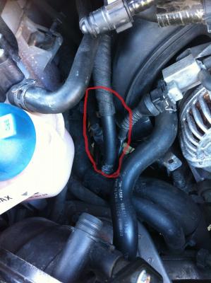

  3. Hi, Can anyone tell me what the part number of the hose identified in this picture as it has sprung a leak (hence the repair tape , :huh: ) I can't find it in PET? Where does the other end go and is it eaily replaced without removing the engine? Was thinking about splicing Thanks Garry
  4. Hi, I have a leak from the pipe that joins at clamp 22, and as you said its not on the diagram. Has anyone any idea what the part number for this pipe is, it runs op and over the top of the engine to the front, looks like a pita to replace? Thinking of cutting and joining with an insert and two jubilee clips. Part number would be a good start though if anyone knows it (diagram and number would help), Thanks garry
