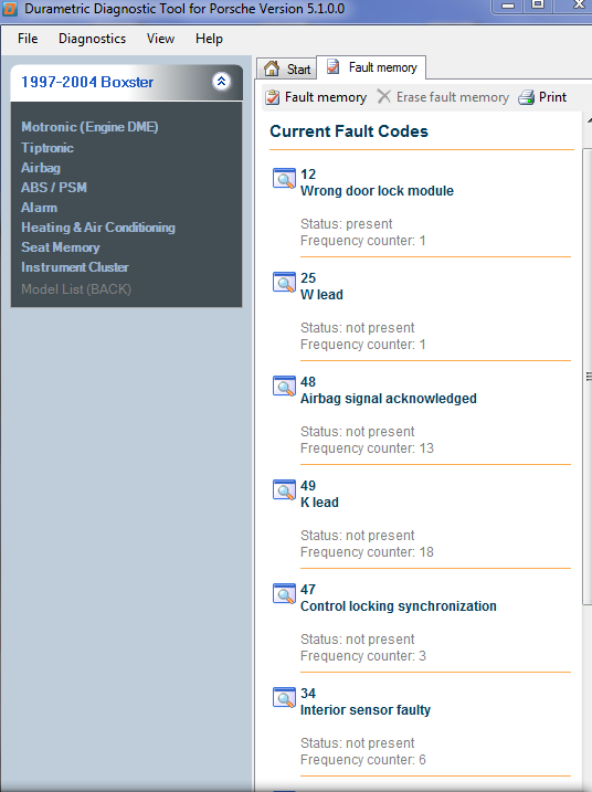

  20. I recently replaced my left door lock on my 2000 base Boxster. The window was not dropping all the time when I opened and closed the door. That problem is gone. Now I'm having alarm issues. The car beeps at me saying something is wrong when I press the remote and here is what Durametric says. I tried disconnecting the battery and no luck. The erase button is greyed out so I cant clear it. Do I need to dismantle the original door lock and swap out something inside?
