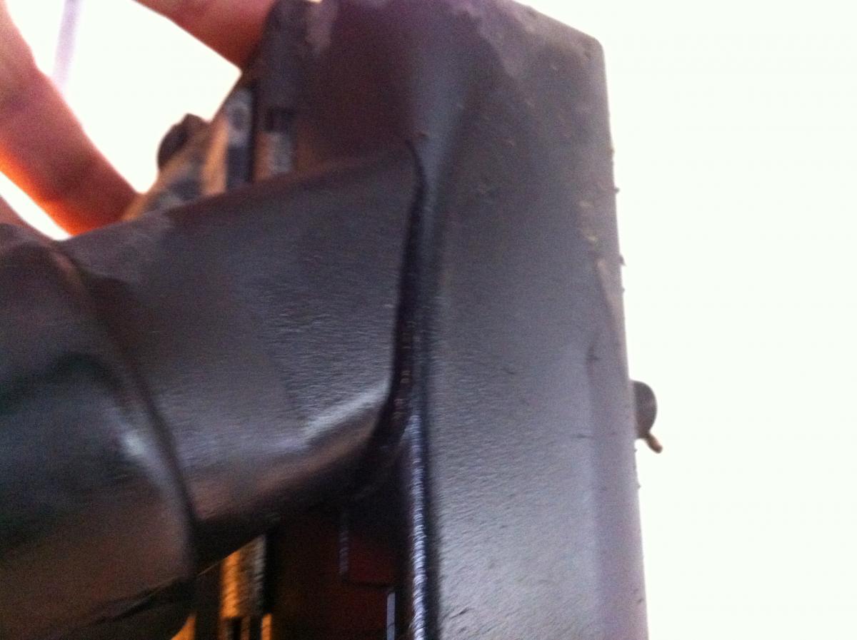

  4. Seen that one, unfortunately its doesn't wrap around far enough to protect the radiator. The lower radiator neck(for a better term) is close to the wheel wells. Also the skid plates would probably need to be mounted to the subframe to provide enough support to protect the lower radiator neck
  5. Thanks for the input, new radiator has been ordered.
  6. Does anyone know of any company that sells a front lower skid plate or any other product that will protect the radiators particularly the lower plasic neck from damage underneath the car? Or is this something that I will need fab up myself?
  7. A cone took out my radiator during the accident avoidence course in the porsche driving school yesterday. It looks like lower radiator plastic neck where the hose connects is the weak point and hangs slightly below the radiator height. If it gets hit I can see why it would easily crack the radiator, nice weak point on the 996. Pulled it yesterday once I got home, would recommned jacking and removing the front wheels but does not have to done as I didn't do it. I was being lazy and next time I will as it would have saved some time and swearing. Can't believe how much work it is to get it out compared to a normal radiator. Thought I'd ask the experts a few questions 1) Any way to repair this radiator (such as jb weld or permatex rad replair) or am I just better off getting a new on 2) Least expensive place to source a new turbo radiator & porsche coolant, have a 996 Anniv and it has the large rad. 3) Easiest way to burp the air out of the cooling system and/or have my indy shop do this part as they have the pressuring system for this. 4) Does anyone know of any idea's or way to protect the lower radiator neck TIA
