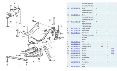

  2. Hi Loren, Thank you very much and sorry for asking that when the document is available on the download section; I didn't identified this "technical information" as a TSB... Luis
  3. Hi, The image enclosed is the exploded view of the rear axle from a 2007 Cayman. Number 3 ® reads: "Side section. Technical information Nr. 4238 20/07" Could anybody please share this Technical information or tell me what is it about? Thanks a lot, Luis.
