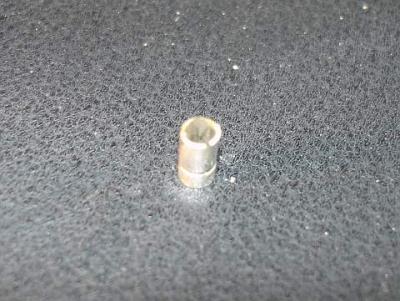

  1. Thanks so much for coming back to me. I can't follow your suggestion because I (stupidly) keep the security socket for my wheels in the boot - so can't get the wheel off :cursing: I keep it in there because I thought if I kept it in the car someone could steal my wheels after i have spent a fortune having the rims rebuilt/refurbished....
