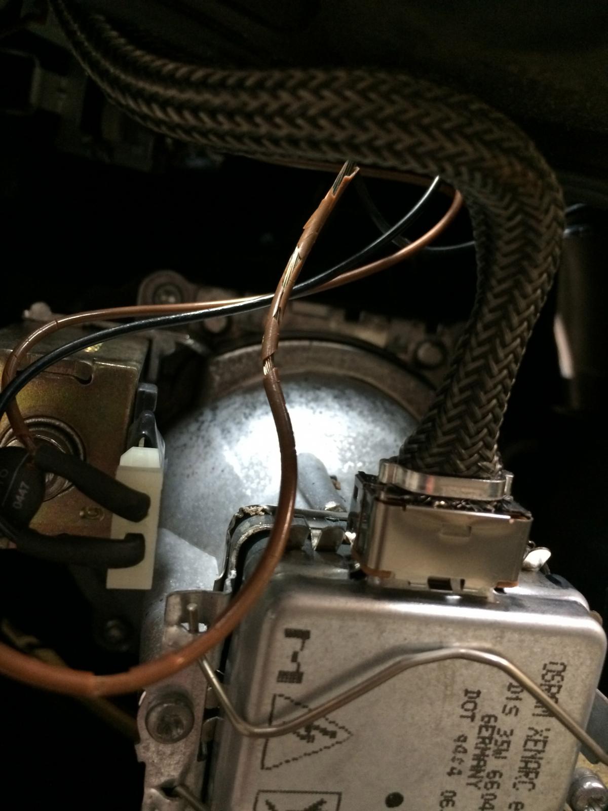

  4. Cut off two of the spade connectors to the cornering light and the ground for the light and used shrink tubing. Replaced the ends. Just taped the others until I can come up with a better solution. Lenses are beginning to yellow again. Polished about a year ago. May just have to break down and spend the money on new lights. Anybody have a deal on them? LittlePorsche
  5. Has anyone seen this before? I have a 2006 Cayenne S. Had left cornering light warning. Went to replace the bulb and found the wires inside the headlight assembly had deteriorated. The insulation was crumbling on most of the wires inside the headlight housing. I had noticed flickering for the last couple of weeks. Could this have been the root cause of the problem? See attached pictures. Any suggestions as to how to go about fixing this? Have not found this harness available (only the one on the outside, or the one for the headlight). Thanks, LittlePorsche

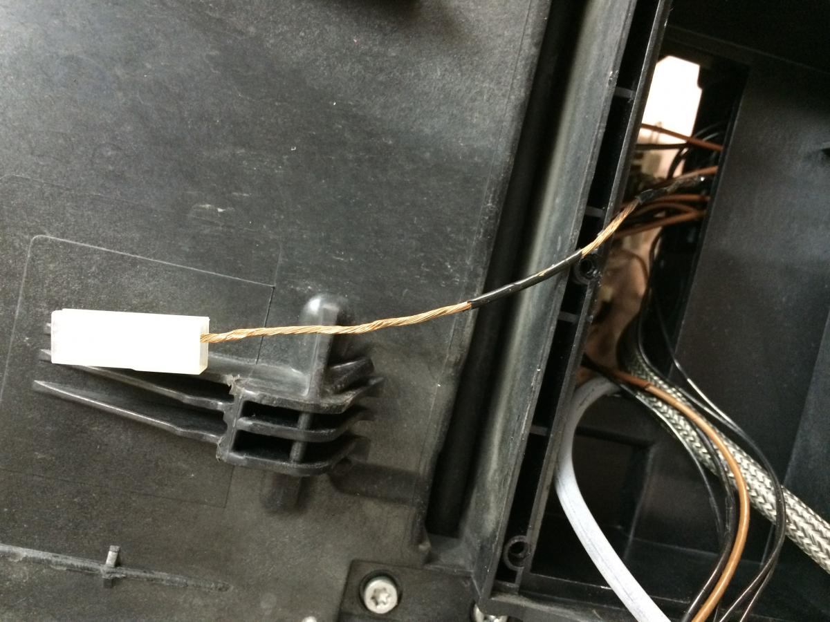

  7. I was in the process of fixing the high pitched squeal of my AC blower motor and found a black box attached to the back of the glove box. It carries the Porsche part number : 955.610.107.02. The word "gateway" intrigued me and am just curious as to what this is. It was found on my 2006 Cayenne S. Thanks
