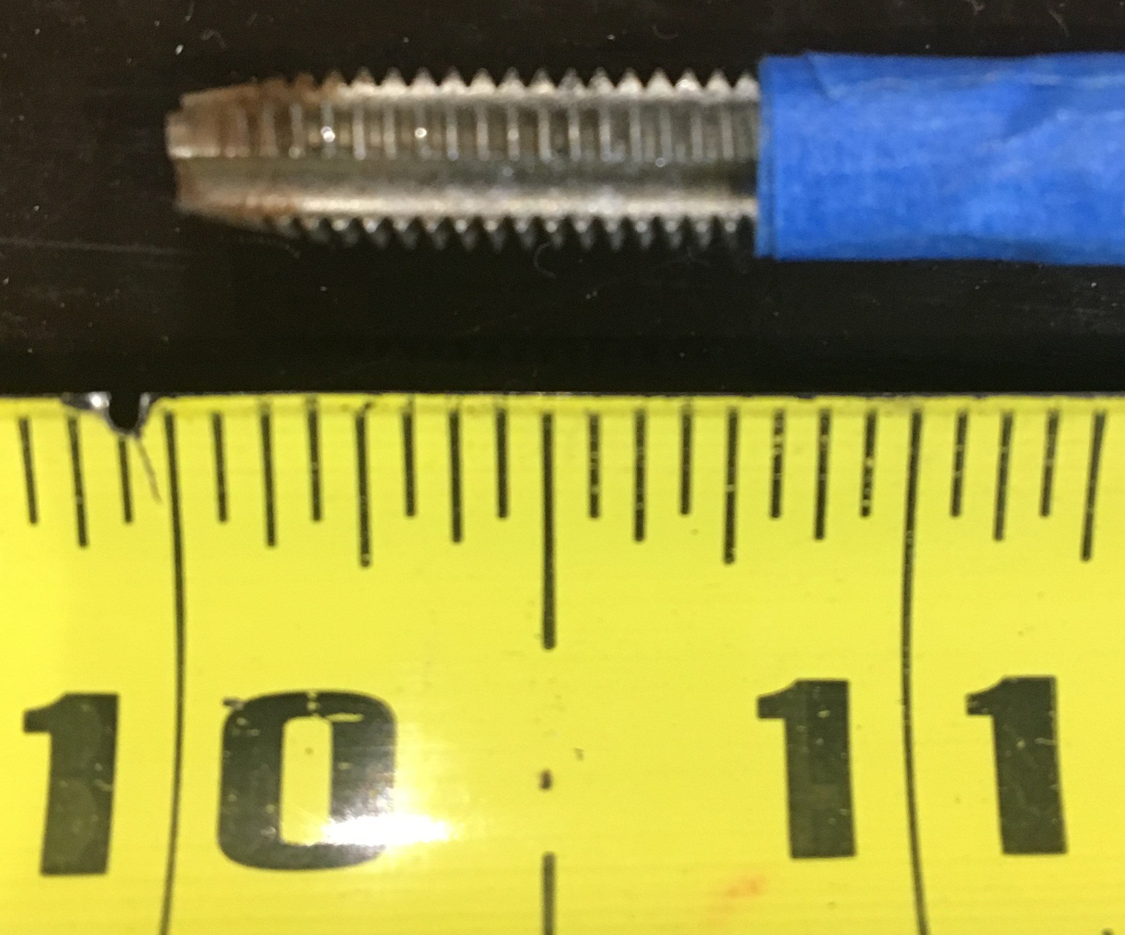

  1. On my 2000 C4 I was lucky enough to have nylon screws. They broke of course, but drilling and tapping was easy with a few tricks and observations: Using a soldiering iron to melt a hole through the center of the nylon screw makes drilling MUCH easier Used a 3/16" drill bit to remove the majority of the nylon then used a 6mm x 1.0 to clean the threads Plunge depth is 3/4" Use a "bottom" tap rather than a "tapered" tap so you clean threads quickly and without significant insertion.
