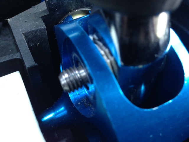

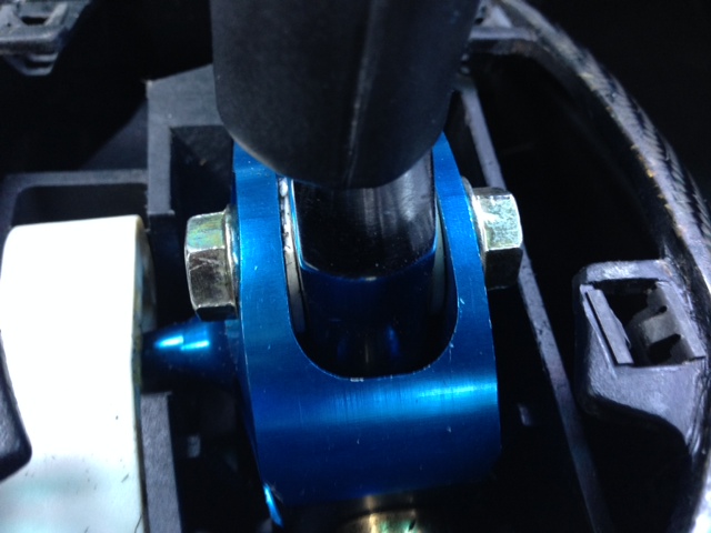

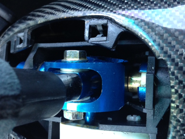

  1. Yes, it looks like the nuts act as compression of some sort and not to hold the threaded stem in place. i removed the nuts and the lack of compression actually lets the throw work now. I'll contact B&M and see if I can get a new unit... I do not think I can get to the problem as it looks like its manufactured into the unit. I'll post here when i find out but for now i'm ok!
  2. i just need to get the white bushing/washer in bottom left picture out and replace it, i don't think i need to remove everything? as you can see its deteriorated. i just can't figure out how to get the stem out where i removed the nuts?
  3. Anyone recognize the manufacturer of this throw? I bought my 996 used and dealer says not stock. Left bushing is deteriorated as you can see making it very hard to shift to 2nd, 4th, etc. How do I get he stem out in order to get to the bushing. I removed the nuts but as you can see the stem is firmly in place. Thanks for your thoughts.
