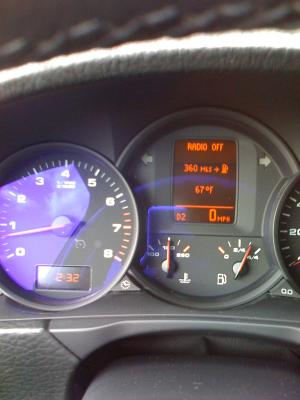

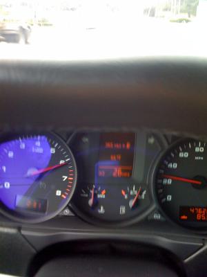

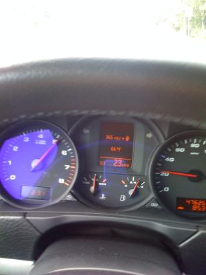

  4. My '05 V6 had a similar problem. During any slightly-more-than-gentle-but-not-harsh acceleration, the RPM shot to the roof, while the transmission would not up-shift. Even at high RPM (red line) and 3rd gear, for example, the speed would not exceed 20MPH. Usually that ended up in a "bang" which shook the entire vehicle as if it hit a wall, and then everything went back to normal. However, if the bang didn't occur, the gear would get stuck, even if the vehicle was parked and the engine was turned off. If you check out my attachment, you will notice that the vehicle was at 3rd gear when the engine was off, and it started at the 3rd gear, which I felt like it was really at the 1st gear, as it would not go over 20MPH even the RPM constantly hitting close to the red line. Ultimately, it also needed an automatic "bang" to bring itself back to normal state. The dealer couldn't get a code, and couldn't duplicate the problem, but they replaced the entire transmission after I showed them 3 video clips of different occurrences, and that solved the problem completely. On the other hand, I was surprised that I was able to duplicate the problem on a '04 Cayenne S loaner that the dealer lent to me during the repair. I think it may not be uncommon. ps. It first happened when switching down gears manually, but later problems occurred any time the vehicle as accelerated slightly faster, and it would not up or down shift even with Tip Tronic.

  18. I just had a dealer replaced the transmission on my Cayenne. The gear occasionally locked at 2nd while the display told me it was on the 3rd or 4th. It didn't make sense since the car would only go as fast as 20 MPH while the engine revved to the red line. The computer would not even record a code. I managed to take some videos and got the job done. I drove a 05 Cayenne S couple of months ago. A similar problem happened to me once, while the transmission was on automatic shift, and I accelerated it pretty good from about 30 MPH. I heard the gear "de-clutched" and the engine was revving when the vehicle was losing power and speed. Then a big "bang" from the bottom up. It was like the car was gonna blow up. In fact, that was the original symptom on the Cayenne V6. Now I see this and start to wonder if this problem commonly exists across all Porsche models. Here are some of the videos I mentioned earlier. http://signage.pro/client_dl/1.mpg http://signage.pro/client_dl/2.mpg http://signage.pro/client_dl/3.mpg http://signage.pro/client_dl/4.mpg
