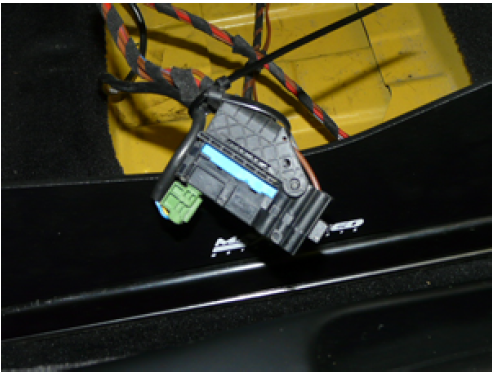

  1. Reminder: I am using the factory seat belt and the seat belt cable is plugged into the main receptacle as shown in the picture Below is what I found in other article: I assume there's at least three wires going to the receptacle - power, continuity that the receptacle is plugged in, and continuity when the seat belt is plugged into the receptacle. People suggest to place a 100 ohm resister on the receptacle if you want to by pass the factory seat belt cable, but in my case I do have the factory cable plug into the receptacle. Out of the 3 cable listed above, I am missing 2 cables (the power and the continuity that the receptacle is plugged in) In my case by placing a resister in the receptacle, will it solve my problem? thanks

  5. I just want to know it is by design after I switched to after market GT3 seats, my airbag light will always turn on? I attached a picture of the connector, notice that only the seat belt cable is attached to the main switch thanks

  7. Here is more information My replacement seats has no cable came with them (no electric parts), it is just a manual control seats. I realize that on the factory seats, they came with a number of connectors that go into the main connector (which came from the cable attached to the bottom of the car) after I switched the seats, the only cable that connected to the main connectors is the seat belt cables. On the driver side, the seat belt cable connector is blue color with 4 pins, it is connected to the far end of the main connector On the passenger side, the seat belt cable connector is green color with 2 bins, it is also connected to the far end of the main connector I just learn from other article mentioning: The 997 connector comes apart into 3 blocks. One provides the power, one control the airbag and the last is the seat belt lock connection Even though my car is not a 997, am I missing the airbag control cable in my case or it does not apply to me? Thanks
  8. how can I verify I connect the seat belt cable correctly to the cable underneath the seats Do anyone has the Porsche manual on how the seat belt connector plug into the main connector underneath the seats? thanks
  9. My air bag light went off after replacing the factory seats with GT3 seats, Do anyone have the wiring diagram for the seat belt connector. I believe the seat belt connector came is either blue or green and I want to verify I connected them correctly. thanks
