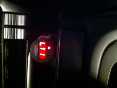

  7. Because i didnt know what they did with the battery, i changed the old one For a almost new one from my garage which i loaded before . This time the meter is showing higher numbers. My question, is it possible to drive the car in this condition? Reading from meter in details: Engine off 12 .50 Engine running 11.9 Driving 13.6

  16. Never ending story ..... I called the shop today. No news. They didnt find anything. I didnt even ask what they did. I just told them to prepare The car, i will take it at evening. So i did. Kessy didnt work. I opend by key. Car was starting without complain. I used this small meter to messure power. It was showing 11.7 After engine run for some time, higher rev and battery warning sign in the display. I played with rev a little bit and felt with higher rev the meter showed 12.5 . Decided to risk to drive home using the highway. During the drive and rpm between 3 and 4000 the meter showed 12.7 to 13 When i arrived home and engine off the meter went down to 11.7 Tomorrow i will try to do something to find what is going on.
