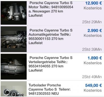

  23. I just found in ebay germany this offer. Only 270 km was this engine running Because i read a lot about guys with serious Engine problems. Maybe this is a chance. Price is really hot imo.
