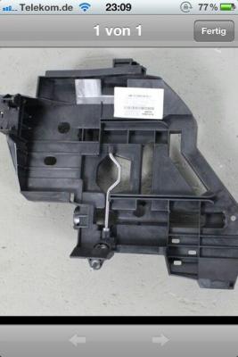

  4. Hi deilenburger No i didnt loose a headlight but the headlight istnt sliding in the right position because this unit which ks shown on the pic is broken in some way.
  5. Maybe someone can help me how to install this Part please
