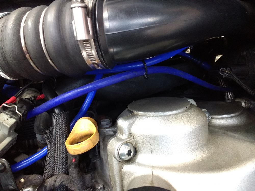

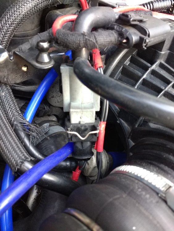

  11. @Zakowsky thank you mike. the throttle body gasket is also new :-) the plastic fitting down to the y pipe i replaced with a pure blue pressure hose. I was cutting out the sensitive connection and replaced it. Very easy to install and very easy to get off. See blue line in the last picture. by the way, the tube is going to the firewall and is connected in the same way to the intake manifold. This connection i replaced in the same way as you maybe can see in picture no. 8.

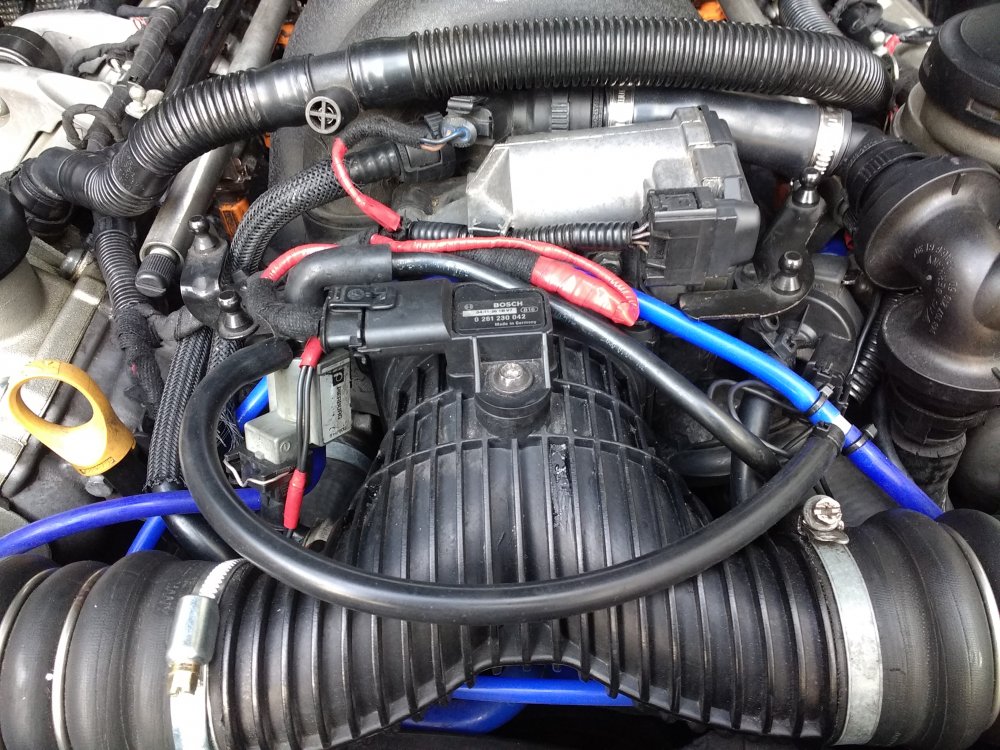

  14. Guys would like to ask your advice. I can't find the reason for my overboost codes. I changed almost every single pressure line which is involved. the pressure valve which is connected with pressure lines. DV valves on both sides. Purge Valve. Connecting hose from Purge valve. Wire connection from purge valve. All vacuum lines behind the intake manifold. And and and. But I still can hear a wining whistle sound when the turbos start to work. At higher rpm the whistle is disappearing. Any idea?

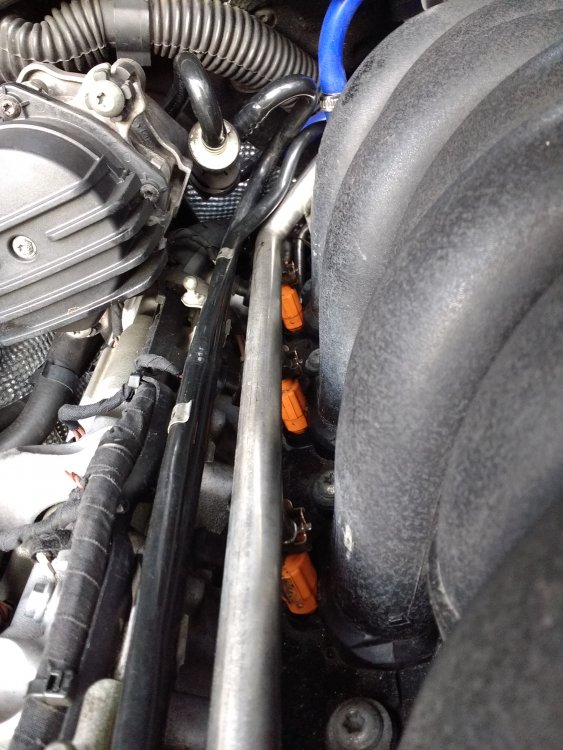

  15. Found the problem. The tube which is going from the purge valve along the injectors to the firewall had a very major crack. Solved

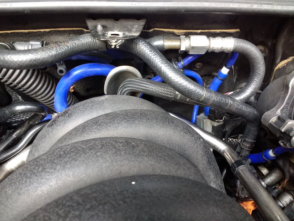

  16. Please would somebody explain me the routing of of the pressure lines close to the firewall. Line 3 & 14 are connected with each other. Coming from the calve. But line 14 has a dead end. Can somebody explain the reason? Thank you
