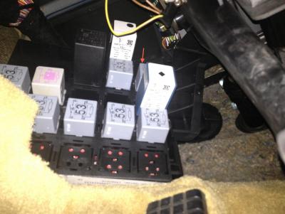

  2. Update - Jimmy3530 is correct, as per Loren's directions. The relay to remove cannot be seen in this photo (hence my confusion). The relay that was to be removed is behind the tall black one in the photo, which is to say, third from the left, top row. Replaced it and my hyper flash is gone. Thank you!
  3. Thanks. Though from Loren's description, the relay you refer to is not on the top row. I pulled it anyway, and replaced with the one from superbrightleds.com, and my lights still hype flash on turn signal. So to confirm, it is the large black one in the picture that needs replacing?Thank you,Keytohwy
  4. Is this the spot I should be looking and replacing?

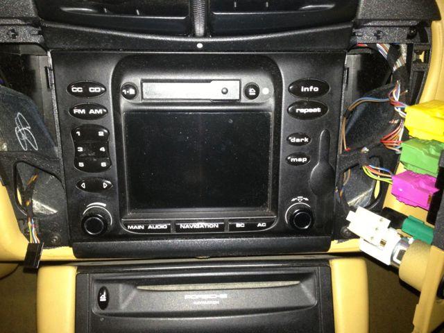

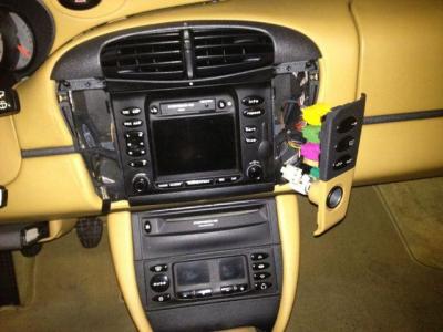

  5. Thanks, to you both. I simply could not wiggle it out. I've now taken the entire frame out. That was simply enough by removing 4 screws. Once it was completely out, I was able to remove the unit, but it was still VERY snug. I could have fought it for quite a while with the normal method of removal and still probably come up short. Thank you!
  6. I've searched and searched and cannot find the steps for removal of a 1999 Nav head unit. To be clear which model, I've included pics. Thanks for any help!
