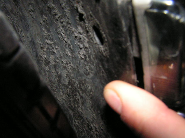

It looks like part of your wheel well lining is missing including the rubber lip that hangs down and the air duct for the brakes. Look at the wheel well lining diagrams and make all the parts are there. As I recall all of those items are held in place by a long self tapping screw that attaches to the bottom of the radiator bracket.
Hey Loren, you are right the hang down diffuser is missing, well most of it. My ground clearance is about 2.5 inches so I know why they are not there. It seems as though the rest is there except a un identifiable stud that a self threading nylon nut goes on to hold the well liner in place it is noted to be directly behind where the turn signal snaps in. I see a hole but not a stud nor where a stud could of possibly been? The Porsche liner schematic shows the nut but not the studs whereabouts. So can anyone identify the stud or bolt that is supposed to be here? TIA
