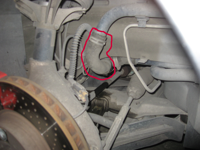

  12. Well it looks like it is #6. The old owner modified the **** hose so it didnt look like the single "y" hose.
  13. Anyone? Not even the local dealer was able to figure out the part number. :(
  14. Front passenger side. I looked at a few diagrams but just confused myself. lol Thanks for any help!!!!
