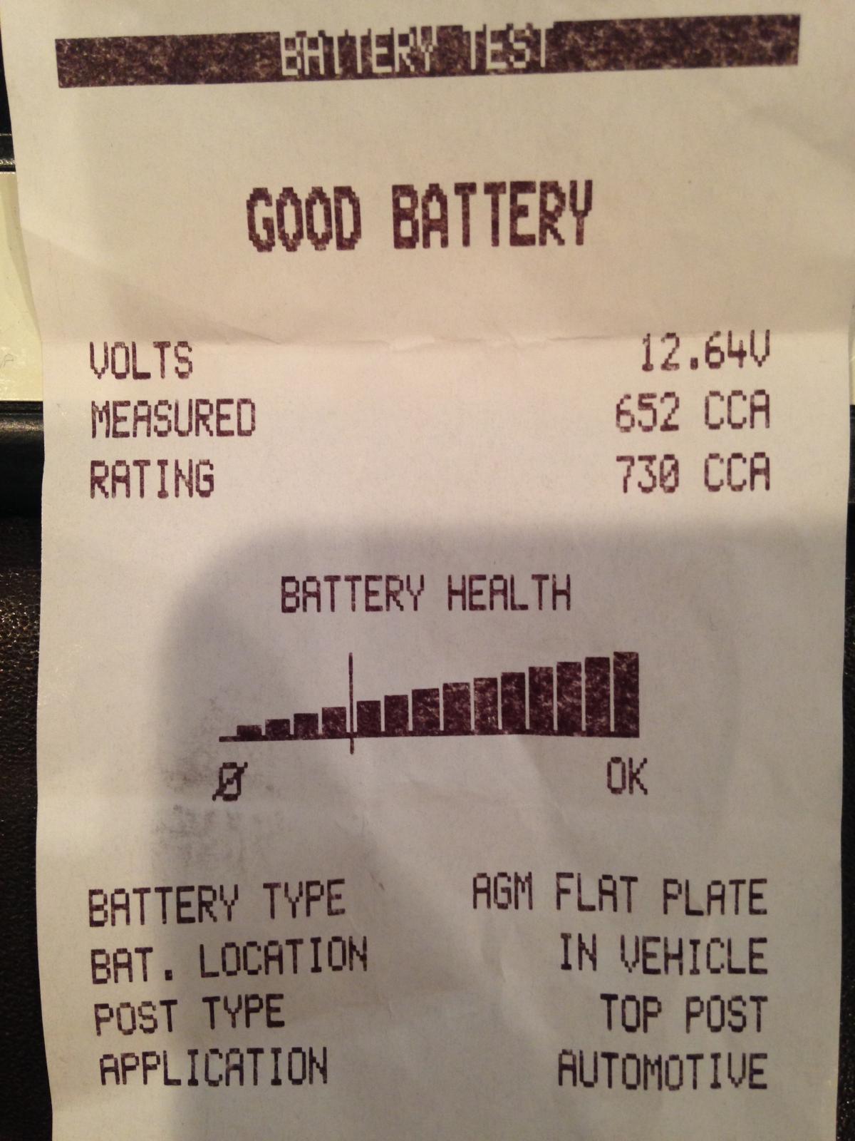

  10. Hi Loren, I don't think a wire was loose when I reinstalled the electrical portion of the starter. I did that last August and have since driven the car 25k miles with no issues. I took the car to get the battery tested and attached are pictures of the readout. I do not think I had the lights on when I had the power dropout on my radio/instrument panel with the car off, but ignition left in the "on" position. The most baffling part was the dropout with the car not running. Why does the reading say "Good battery," but the "Battery Health" is rather low? Swaff
