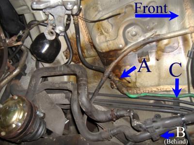

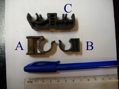

  1. I certainly would but it seems I am drawing a blank. In fact I may order a couple of clips, supports, whatever they are called, one blindly (no image) and another will need modification to work. If either or both work out, I will post. In the meantime plan B involves P clips and gripper washers or the same plastic nuts as used to retain the underbody cover panels, to achieve the same result. Not ideal but better than reusing broken clips. Frustrating.
  2. The clips don't have any separate screw to attach to the body, they are screwed on themselves (rotated in their entirety). Today I went to Porsche and it appears that their PET is no better than mine. Could not find the clips, also mentioned that there is a "missing" bearing for the gearbox on my PET and sure enough it was missing on theirs too...

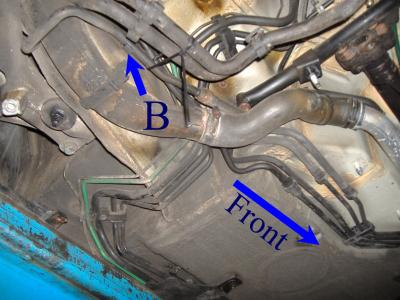

  3. Haha well these little mysteries are always fun! I did post elsewhere, but hey, everyone can play! Mystery pipe clips, can't find on PET, and need ordering as they have split... there is one clip in PET that does not included in the image, not numbered, and may be "A" but unsure. Believe me I have been working my eyes out studying PET but I don't have any definitive info on anything Any ideas? I win the prize! Well I don't, you make me spend the money... Here goes! A and B are critical. C not a problem. Have fun and win for me!

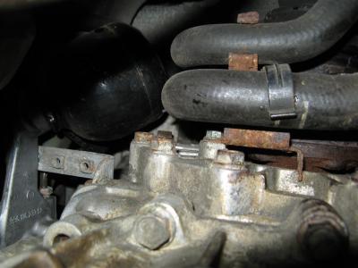

  10. There is a support bracket attached to the RHS of the tranny/diff (rear), for narrow gauge coolant hoses, must be for heating hoses. It's very rusty and needs replacing, but on Porsche's parts list "Katalog" there is nothing that looks quite like it. It could be 99610653631, (but is not, unless the 6sp one is rather different) and it's the same story with 99610652672 They really are not what I want, at least not in the images provided, but I understand that the images shown are for the Tip version bracket/s, so I am lost. This bracket is attached just by the RHS CV joint. In the pics, the rusty part, with the "fork" slot to prevent rotation while doing up the retaining bolt. All images online point to the same Porsche drawings, so not much help there! Any ideas? Thanks in advance... EDIT - apologies I put this in the wrong forum, had too many open windows... if a mod can move this that would be great!
