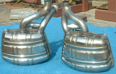

  4. If your referring to FisterD's response. The left side is the MK2 and the right side MK1 type mod. I don't follow the MKI, MKII designations...sorry or the confusion. I classify my muffler mods by "stages". The less aggressive, less loud being "I", and the louder , more aggressive being "II" My Stage I (MkII) is the milder, less aggressive mod. Connecting the third unused port to the outlet. My Stage II (MkI) is louder and more aggressive sounding. connecting the inlet directly to the outlet. Hey fisterD. What mod did you do on your exhaust? Is it 3.4 or 3.6? Is it a significant difference. I remember seeing a reply on thread indicating the mod for "Stage I" MkII doesn't pose any signifcant difference on a 3.4. Anybody else who have a 3.4 exhaust that can comment on this. Please indicate if the mod is MK1 or MK2. All your inputs will be appreciated. Stage I (mkII) only works on 3.6 mufflers. Stage II (mkI) works on both 3.4 and 3.6 mufflers I have a 993 and run Fister Stage IIs on it......and it sounds wicked! I have done many 996 Stage II mods to 3.4 mufflers with great results. I use a larger diameter pipe than most.
  5. If your referring to FisterD's response. The left side is the MK2 and the right side MK1 type mod. I don't follow the MKI, MKII designations...sorry or the confusion. I classify my muffler mods by "stages". The less aggressive, less loud being "I", and the louder , more aggressive being "II" My Stage I (MkII) is the milder, less aggressive mod. Connecting the third unused port to the outlet. My Stage II (MkI) is louder and more aggressive sounding. connecting the inlet directly to the outlet.

  10. This is a 996 with the mod. Here is a 996 with Stage II (MKI)996 Stage II I prefer to do the mods all in stainless. Stainless tubing and weld it with stainless.
