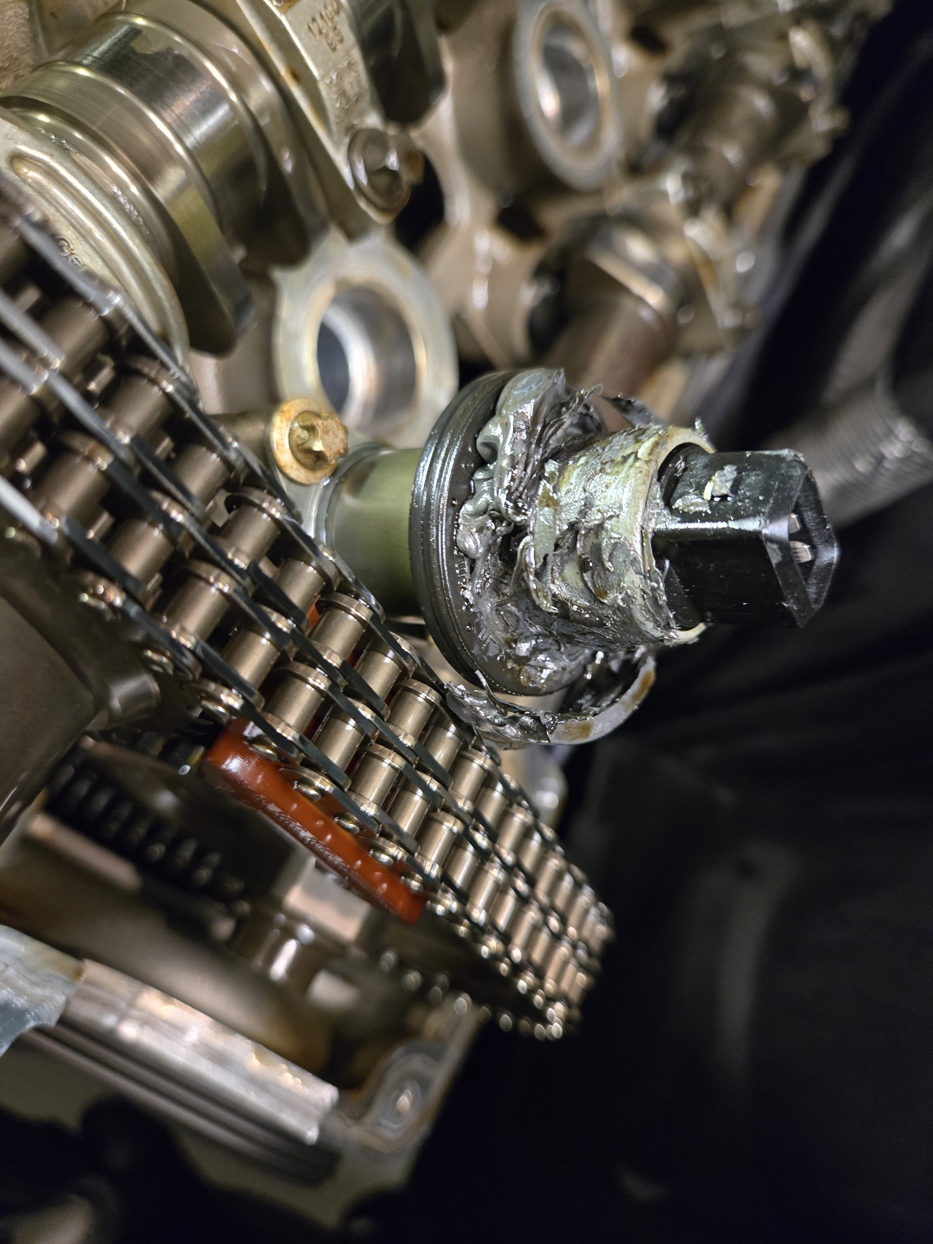

  12. 2008 S. I'm looking for advice and I have a few questions, the Cayenne S that I'm working on that I'm replacing the valve cover gaskets well doing that I found a broken hose, that it turns out to be the vacuum pump hose, while reading up on the vacuum pump I read that they tend to leak and they go bad often, I have not taken it apart yet so I don't know if it has a problem yet but with the Cayenne pushing over 200K I think I should replace it while I have the valve covers off. now the questions. Has anyone replace the vacuum pump yet? Do they go bad as often as I read? how does it leak oil and from where? it looks pretty simple. two oil rings to the head and one in the rear with a backing plate. Does anyone know what the vacuum connection do? the pump had a small vacuum line port with a small vacuum line going into it and a larger line going to the firewall. the strange thing is the large line that I saw cracked on both ends the car still had power brakes where is it getting vacuum from, unless its getting vacuum from the smaller line. one last question. where is it sucking air out of? it can't be the head, or the intake, it is from a manifold that then has lines running to a bunch of different locations? Sorry for all the questions I like to know how things work.

  15. Guys I have the drivers side valve cover off and I'm in the process of cleaning it. I know I need to put a small dab of threebond where the block meets the chains cover. Can I use some threebond to hold all the gaskets in place? when I took the valve cover off it looks like someone already tried to fix the leak but the gasket feel out of its slot and was pinched, they also tried to use silicone to stop a leak on the cam actuator. I read the way to install and torque the bolts is to 7.5 ft lbs in a crisscross pattern starting from the middle of the valve cover and work my way out. If anyone can offer any advice to make the job better and avoid future leaks I would love to hear it. Once I have this one don't I will move to the passenger side. 2008 Cayenne S
