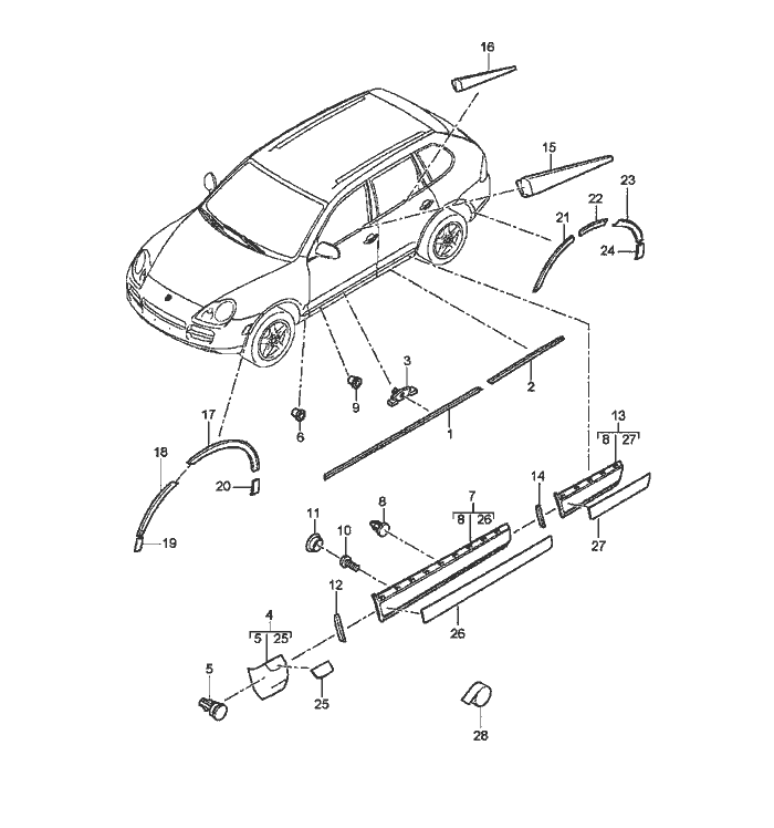

  1. Success! 1, 3, and 9 in the diagram. I just needed to know it was called a "Door Sill Rail." Door Sill Rail Clip - 955-559-547-00 Door Sill Rail Grommet - 955-559-547-00 Door Sill Rail Front Driver Side - 9555593030201C Door Sill Rail Front Passenger Side - 9555593040201C

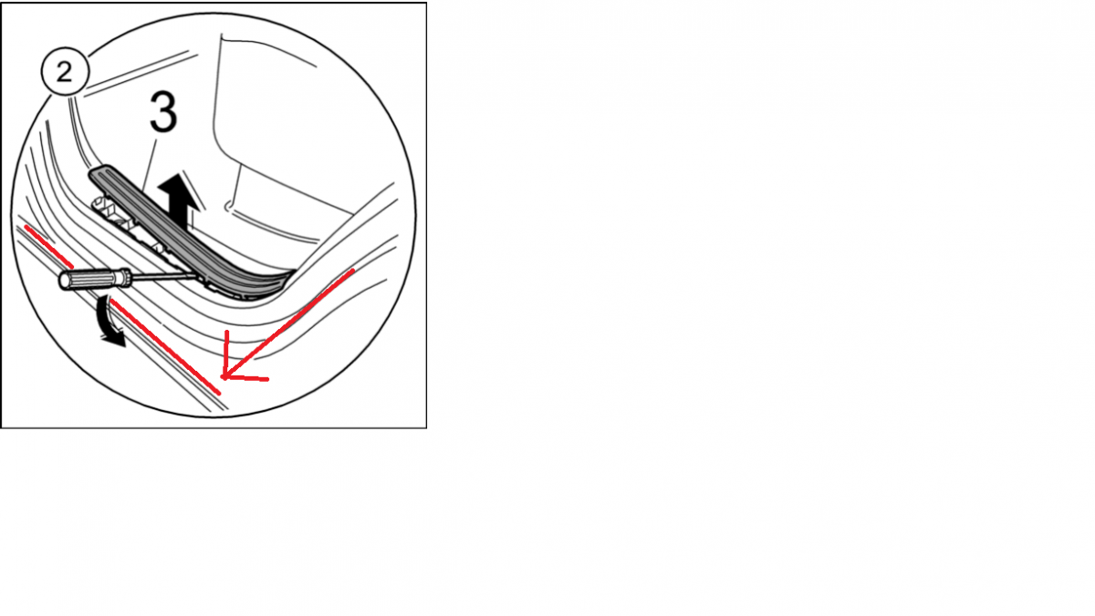

  2. I can't find this part in any of my diagrams, but they've detached from behind both front doors. They're easy to step on when exiting and are anything but sturdy. They're a sort of plastic V channel with clips(also broken or missing) holding them to the rocker panel. I've attempted to illustrate their location in red.
