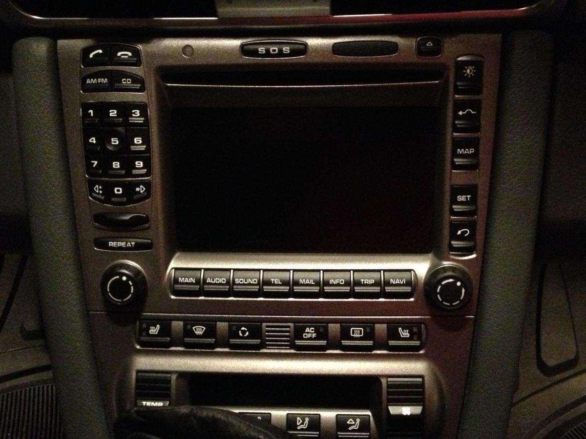

  8. @Loren. Thanks for the quick response, but it didn't help I'm afraid. My PCM looks like this:
  9. Just acquired a 2008 Carrera 2S, but it came without owner's manuals. No problems finding the basic manual, but I need help finding the manual for the PCM - the one with phone buttons on it. Any suggestions?
