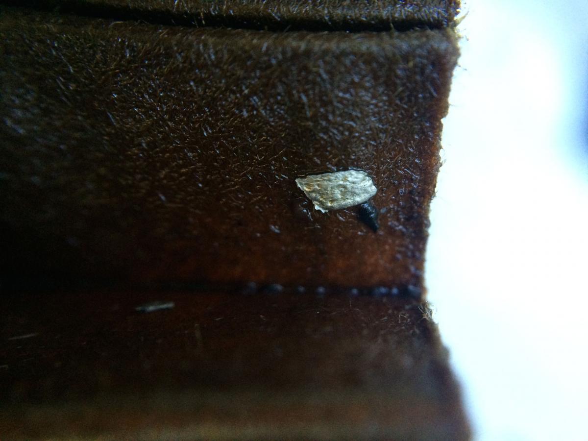

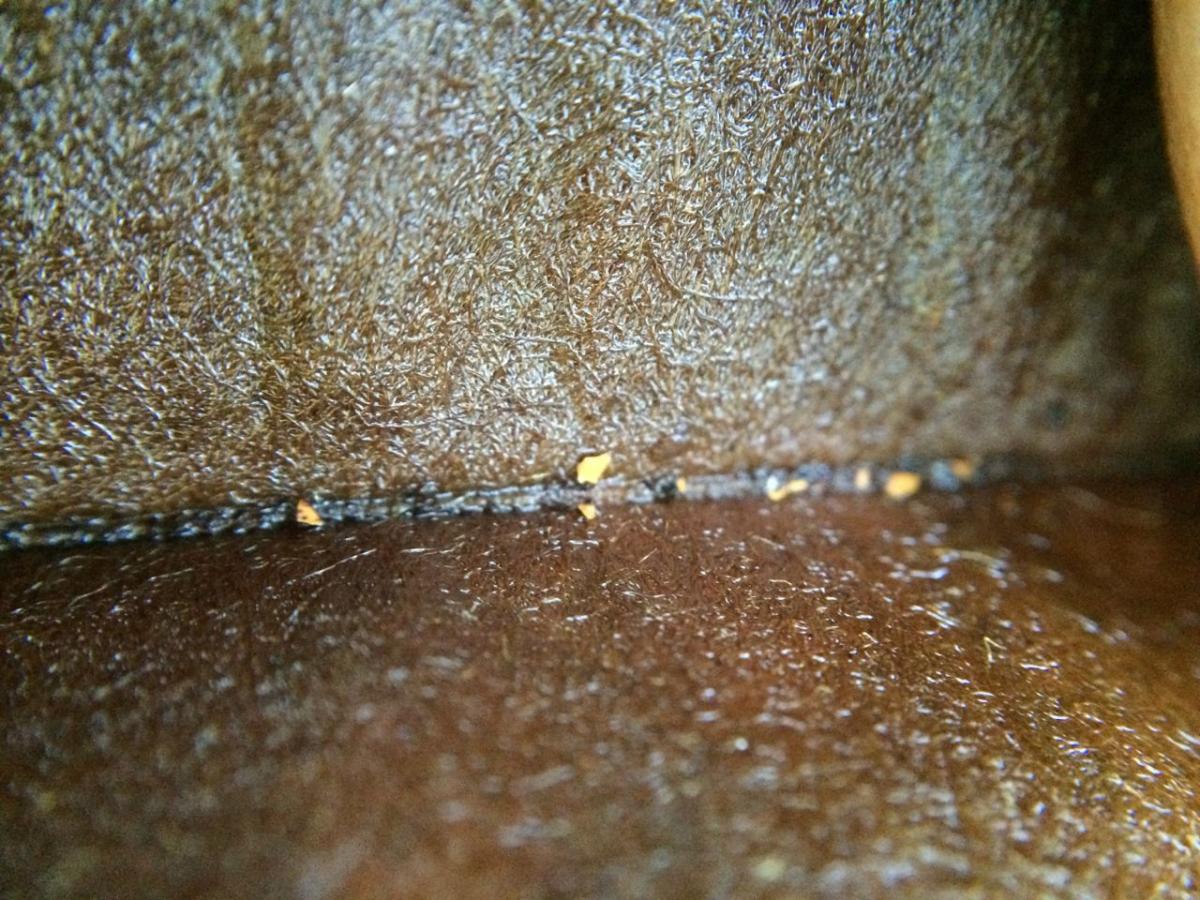

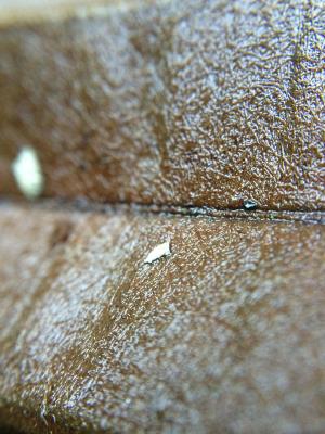

  3. Hi Renntech'ers! This is my first Porsche. Bought it about a year ago. 2002 with 60k miles. Original IMS. I drive it only a few thousand miles per year, including occasional AX'ing and an annual track weekend. But I'm nervous about the IMS, so I'm changing the oil (Mobil-1 0W40) every six months. The first oil change revealed only some black plastic bits, which did not raise concerns. The second oil change (yesterday) revealed a few metal bits. The largest was a flat flake a approximately 2mm x 3mm. There were a few smaller ones. And there were some tiny flecks, which may have oxidized overnight(?) since they appeared orange/brown by the time I took the pics the next days. There were no metal bits on the LN magnetic drain plug, however, the plug was covered in a kind of silvery, greasy residue -- kind of like a silicon grease. Please see attached pics. Are these cause for concern? Thanks! Charley

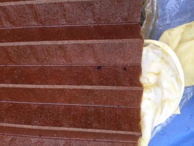

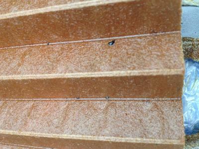

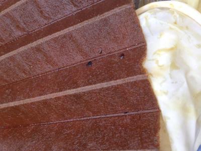

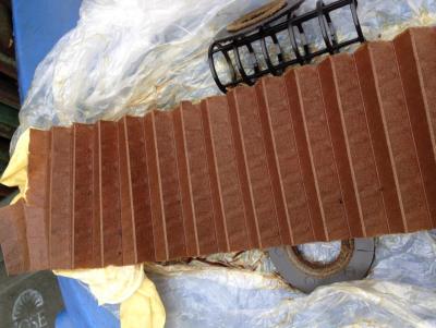

  6. Just bought my first Porsche, a 2002 Boxster with 58k miles. IMS has never been replaced, and I believe it has the single-row bearing. I've had it for a few thousand miles and it's twice made an unexplained grinding some that... scared the hell out of me for obvious reasons! I can't figure out where it came from or what it was. My indie tech thinks it might have been the non-Porsche brakes that the prior owned had installed. It will be due for a new clutch sometime in the next 10k, and I'll do the replace the IMS with the LN retrofit at that time. In the meantime, I'm rolling the dice. So, being a bit nervous, I did an oil change even though it wasn't due. I cut apart the filter. No silver metal at all. But a few black bits, which seem to be perhaps plastic. They're not metal (a magnet doesn't attract them). It's possible that they are from from when I cut (with a hacksaw) the end of the plastic part of the filter. But some of the black bits were deep in the recesses of the filter folds when I unfolded it, so that seems unlikely. Pictures below. Thoughts? Thanks! Charley
