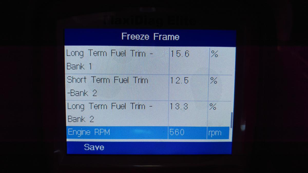

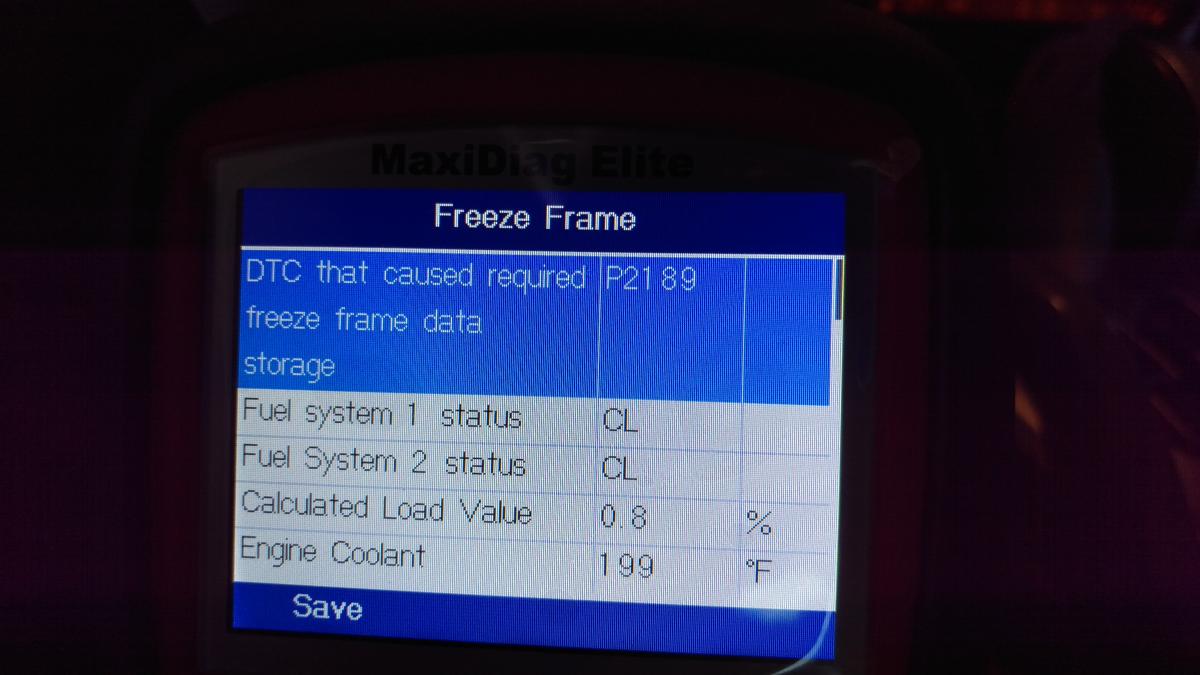

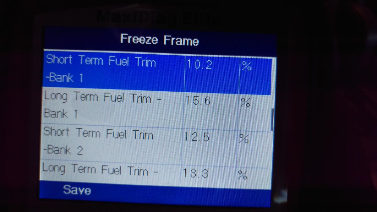

  24. It is an Autel MD802 all-system...it reads everything but doesnt have bi-directional. I dont have a durametric. Im not sure...where should the trims be? Edit: looks like they should be as close to 0 as possible? Is this a legitimate test? For a suspected vacuum leak, note the fuel trims at idle and increase engine speed to 2500 RPM and hold. If the STFT immediately decreases and moves to acceptable levels and the LTFT slowly starts to come back down, you have a vacuum leak.
  25. P2189 came back. Attached pics of the freeze frame if that helps. I think I'm going to take that hose off again and tape the rest of it as it crackled anytime I moved it during removal.
