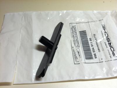

  11. This thread is a great resource for anyone that has been frustrated by Porsche's lack of forethought in this matter. I just ordered a couple plates from Sunset Imports in OR and they were not too expensive ($24.86 ea). I attached a couple pics. At this point, I just need to schedule the installation on a free weekend to get them in.
