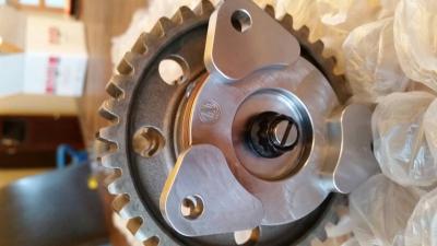

  17. What happens if I try running the motor with just the plug in? Remove the piston and spring & see if get pressure??
