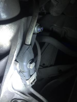

  2. Been having problems with intermittent brake wear light and found the plug where the speed sensor and brake wear sensor plug in to be cracked and breaking up. After a search found a topic where Loren found a wiring repair kit for these plugs but for the rear. Need part numbers for the front part repair kits. 1999 carrera tip coupe. Thanks in advance and pic.
