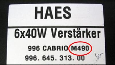

  9. Do you have separate sound system control below your radio in the center? If so, you've probably got the 680 DSP. If not, then as long as you have door speakers, you'll have the M490 pkg. You can check the options listed on the sticker in the front trunk, or look at the sticker on the amp in the front trunk. The front trunk sticker will just list option 490 or option 680. If you check out the amp, your sticker will look like the one below except your part # will start w/ 986.... and will either have M490 or 680 where I have circled in red:
