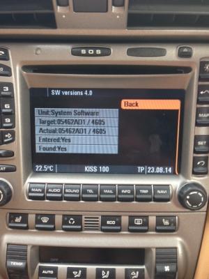

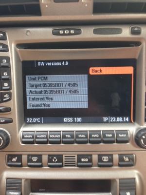

  5. Hello, Thanks for the reply. No it does not. I then tried pressing 1, 4 and 8 together which done the reset and when It came back on I did the MAIN and TRIP together again which still only showed whats in the photo. I also checked the trunk and don't seem to have any drives. I take it that it means it does not have it? Do you know roughly how much it is for the sat nav and phone? Thank You Matt
  6. Hello, I have just bought my first Porsche 997.1 2006 C2 with the PCM system (which I think it is called) Everything seems to work fine. The CD player works perfectly fine and it all seems good. Except for when I press Tel, Mail, Navi or Map buttons, I get the following error along the bottom of the screen Navigation not available Map display not available Internal Telephone not available Mail not available Depending on what one I press. I receive no manuals for the car and bought from a used car place which didn't really no much about Porsches. Does this mean, I need a CD? or does it not have navigation? or could it be faulty? does it need a sim card for everything to work? Im just lost. I do not have any CD drives or anything in the trunk but it does have a type of sim card tray on the front of the unit that ejects Any help would be much appreciated as I really just want the navigation on it. Thank You Matt
