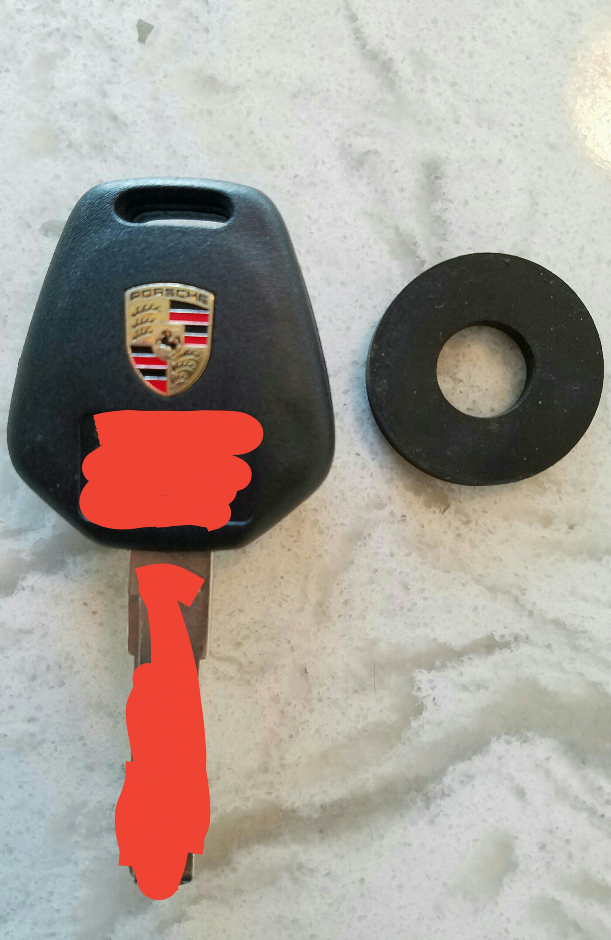

    10

  1. Interesting. Mine doesn't have a plastic plate or washers behind the plate - it just screws right into the body. I wonder if a previous owner went to change plates and set the washer on the spoiler grill and it fell inside, and since he couldn't find all the parts, just got rid of the plastic plate completely, and I never knew I was missing it.
  2. Thanks RFM. I'll pull the whole filter housing out when I have some time, and check underneath and see if I can find what you're talking about, and if I am indeed missing rubber washer(s) here.
  3. Thanks DBJoe. I posted from my phone and didn't notice the writing in the picture. I wasn't paying attention. I have at least 4 tape measures (zero rulers) around here, but none were to be found when I took the picture (I'd love to blame someone else for moving them from their designated areas, but it was probably me). Modifications made to photo, as I'm too lazy to go back and take another one. Has such a thing ever happened with keys? I'm curious to know. I'm not actually worried someone would go through the trouble of paying to have a key made, finding out where my $15000 car is garaged and breaking in (the garage has CCTV and an alarm with motion detectors, oddly enough), removing the lock cover on the car door, and using the key to enter the car; meanwhile the car alarm is going off and the garage alarm is going off and if they try to start it, the immobilizer kicks in. The only thing of value inside to steal inside the car would be maybe my offbrand dashcam and maybe my prescription sunglasses if I didn't leave them in another car. It would be quite the elaborate caper, but there are much easier and effective ways to ***** me off, if that was their goal.
  4. So today I changed my air filter. When I pulled the filter out there were a couple of leaves underneath as well as a rubber washer. I'm assuming this is road debris, that somehow found its way into the air intake. But I wanted to double check with people smarter than me regarding 996s just to make sure this isn't a part of the rear spoiler wing or something else close by that could have fallen into the air intake. I replaced my rubber bellows under the spoiler wing, and don't remember seeing a part like this, but figured it wouldn't hurt to check I didn't dislodge something. If anyone recognizes it as a part of a 996, please let me know, so I don't throw out a part for my car unknowingly. Key for scale:
