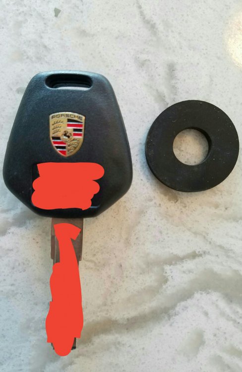

  1. Interesting. Mine doesn't have a plastic plate or washers behind the plate - it just screws right into the body. I wonder if a previous owner went to change plates and set the washer on the spoiler grill and it fell inside, and since he couldn't find all the parts, just got rid of the plastic plate completely, and I never knew I was missing it.
  2. Thanks RFM. I'll pull the whole filter housing out when I have some time, and check underneath and see if I can find what you're talking about, and if I am indeed missing rubber washer(s) here.

  4. So today I changed my air filter. When I pulled the filter out there were a couple of leaves underneath as well as a rubber washer. I'm assuming this is road debris, that somehow found its way into the air intake. But I wanted to double check with people smarter than me regarding 996s just to make sure this isn't a part of the rear spoiler wing or something else close by that could have fallen into the air intake. I replaced my rubber bellows under the spoiler wing, and don't remember seeing a part like this, but figured it wouldn't hurt to check I didn't dislodge something. If anyone recognizes it as a part of a 996, please let me know, so I don't throw out a part for my car unknowingly. Key for scale:
