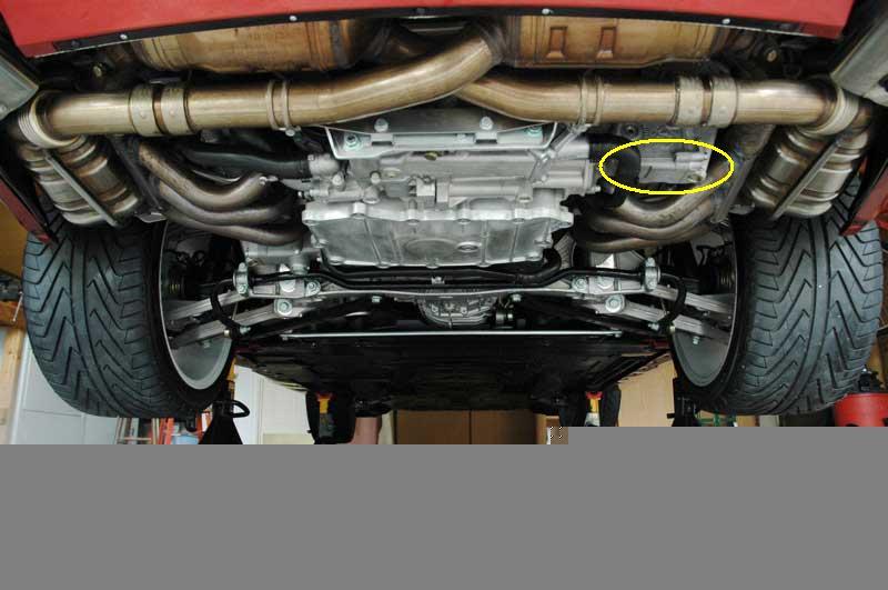

I'm seeing a black residue on the under surface of my engine cover at the highlighted yellow oval (see picture). I'm not sure if it is oil mixed with dust or soot from the exhausts. I don't have a single drop on the driveway. Anyone have any thoughts on this? Thanks

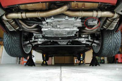

Orient Express: I borrowed your image from the DIY Section, simply because it's so easy to show something on it. I hope you don't mind.

I have the same exact residue that you described in the same location. I have a MY99 C4 Cab. I showed it to the local Porsche mechanic and he said that a flat six will often times weep a small amount of oil and since there's nothing hitting the ground it's fine.

I believe the dry sooty substance is on the Vario Cam F1 equipment, passenger side, am I right? I showed it to a mechanic at Stevens Creek Porsche and he said it's normal, especially since my engine hasn't been cleaned since new, 7.5 years. Perhaps the driver's side Vario Cam isn't covered because the anti-freeze tank above is usually replaced due to cracks, etc, and everything on that side gets wiped down on repair.
