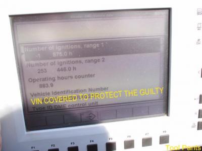

The 'vin covered" picture in the link is one I took several years ago of a 2000 Boxster S at a tech session. That car is still running.
I am not positive about the new cars. On the older models the Range X incidents were based on engine operating hours, not a time or date.

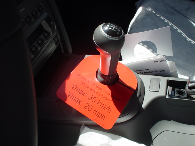

The cars are limited to 20 mph when they leave the factory. This speed limit is removed by the PIWIS at the dealer. Hard to imagine doing damage on the trip from Germany to your dealer with a 20 mph limit, but stranger things have happened.
It is still running - on it's second engine. :rolleyes:
The engine had been replaced before the picture was taken, so the combined info is shown.
Now this 1998 Boxster is a strange one. Minus 1 in Range 1. Something about the memory chip running out of room and the counter starts over with minus numbers. The owner autocrosses. We have another owner with high numbers and he also autocrosses.
