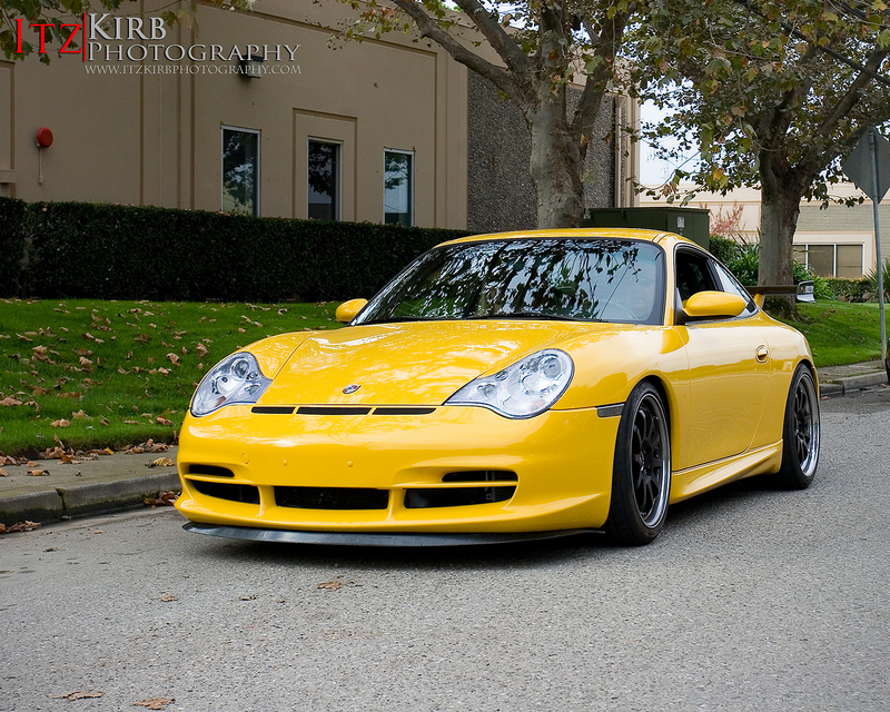

Voila, will look like mine! :beer:

Left mine cf since I have Forgeline SX3 wheels, black centers/polished rims. They complement each other. Also, have the RS vented hood, so a bit of black in the grill coverings there. too.
