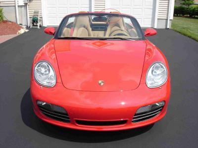

No offense meant... But your V1 location is at a very non-optimal spot. I've had Mike V. in my car myself (took him to the airport from a BMW CCA event) and he stated that the V1's best position is as high as possible on the windshield (with windshields that don't have that "film" that blocks the signal). He explained that the way I had it mounted (i.e. - I had mounted it like yours is now), the unit is pointing DOWNWARD. Signals would have to bounce off of the hood/highway before it would reach the V1. He basically states that you want the V1 mounted parallel to the ground and as high as possible.
After he corrected my installation, I asked him about making a front/rear "bumper" installation. He again stated that they have found it to limit the range by being so close to the ground. Thus, they did not.
In the exterior photo shown in a red circle is where he suggested I install it. The wire is tucked down the pillar on the driver's side. The "concealed display" unit is sitting in front of the gauges - again circled in red.
Edited by M3Armand
