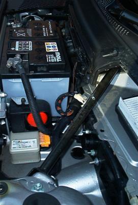

On the 986 it was mounted next to the battery. The black box with the round red thing is the siren. Below that is the tilt sensor. The picture is a UK 986.

The 986 pictures the UK guys took for me show the tilt sensor next to the battery. From reading messages in the UK boards water would get into the sensor and cause problems with the alarm. So the fix was to relocate it to under the seat. No clue where it is on a 987.

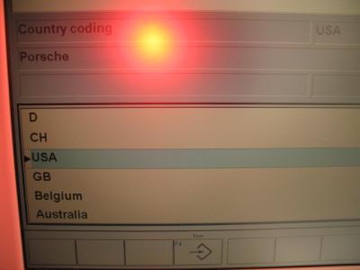

Here is my 986 hooked up to a PST2. I am in the alarm control unit and it sure looks like I can change the country coding.
Maybe, one of these days or in my dreams, I will buy the 986 retrofit kit, install it, then change the country coding for the alarm system from USA to GB and see if it works. I do not know of any American Boxster/996 owner who has done this as 99.9% of us do not know there is an optional alarm siren and tilt sensor for other countries.
The sun looking thing is camera flash.
